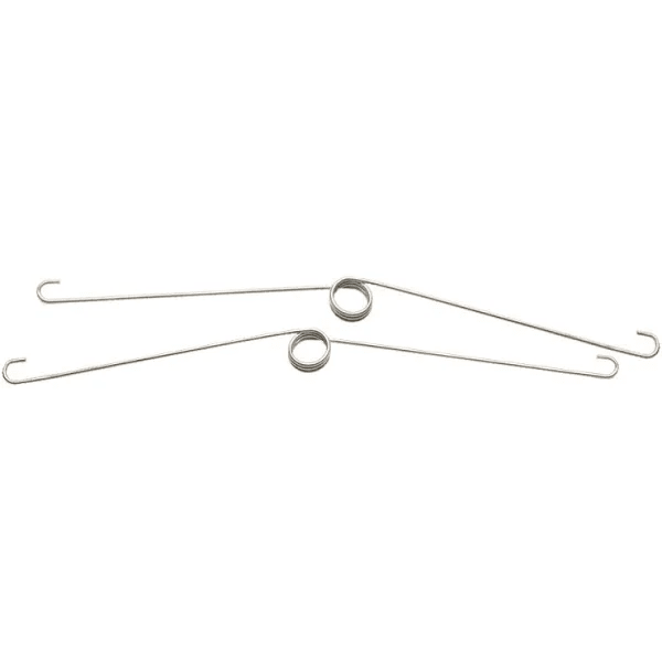

As mentioned... Too much deflection for a leaf spring. Looks like you need a spring similar to those used to retain can lights:
One common name for those is "torsion spring" - in case you need a term for your favorite search engine.

Some reason my boss does not agree with torsion spring. Previously we used torsion unit. production unit had issues .
Dhanish
