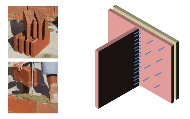

I'm looking at a dwelling with reverse brick veneer construction with a light sheet truss roof. Single storey.
The external leaf/wythe is timber and the internal leaf/wythe is brick. The internal walls are brick.
With respect to the capacity of the internal walls to transmit shear loads:
(1) Is it unreasonable that the internal walls need to be anchored for uplift. The first attached image seems to show a steel rod, presumably for this.
(2) Another question that I have is with respect to the transfer of wind loads between the external wall and the internal perpendicular walls.
Do you ever see many ties as shown in the second image ... or do you assume that typical ties (spaced at 600mm or 300mm near opening and edges), transfer this load to the internal wall?
Issue with internal pressures as well? Or do you rely on shear capacity of mortar?
