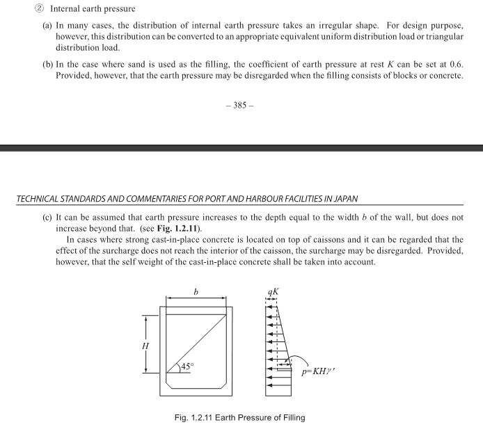

If I have a hollow concrete structure; 5 ft W X 10 ft L X 30 ft H that will be filled inside with soil, and nothing from outside "theoretically".
I need to calculate the earth pressure on all the sides, and wondering if the full lateral earth pressure will be developed within this limited space, or would it be less?
I think the pressure plane will not be developed due to the space limitation...
Would the lateral pressure equation: ϒhko on all sides remain correct, or can be reduced because of the limited space...
If it can be reduced, how can I calculate earth pressure?

Full pressure will definitely not be developed for the restrictions as you said. You also have a lot of wall friction on all sides which will greatly reduce pressure.

I have often wondered about this myself. If the box were filled with water, you would have the full lateral pressure due to water. But soil is different. There is the wall friction effect, as mentioned by EireChch, but I also wonder if you cannot develop a full active failure wedge in such a small space. I think you will get a series of small failure wedges stacked on top of one another.

Check out silo design pressures

I looked at the "silo design pressure", which @BigH suggests. I could get about 15% of the full pressure, which is the pressure I like to see!!! But Is it the correct approach?
Also, the papers I found assume "circular" silos, I thought there may be a further reduction because of the circular shape (?). I could not find anything researching a rectangular container. Could we have different forces/pressures if the silo is rectangular? or would it be the same as the circular?

Here's a published design simplification.
