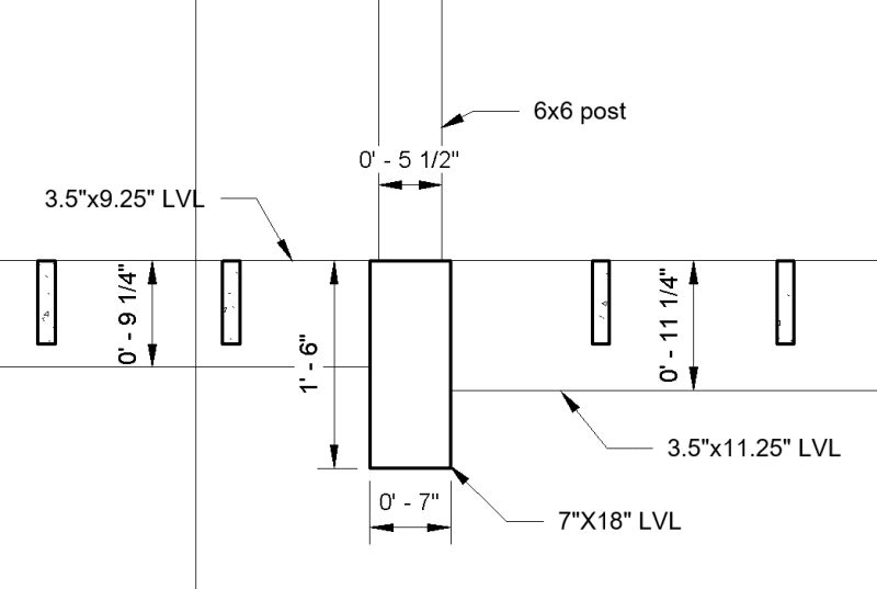

I have attached a snippet of a plan view and a section cut showing what is going on.
The post is a 6x6 and the LVL supporting it is 7" wide so they do not align perfectly. The net uplift on the post is around 1800#.

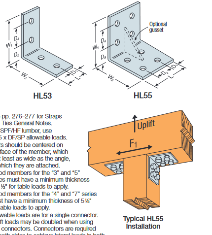

I also thought about using HL angles per below. This would have more redundancy as there are multiple lag screws that would be used, but another problem that I see is drilling 1/2" to 3/4" wide holes into the top of the LVL. That could take away more than 10% of the LVL's width which would push it to being overstressed.

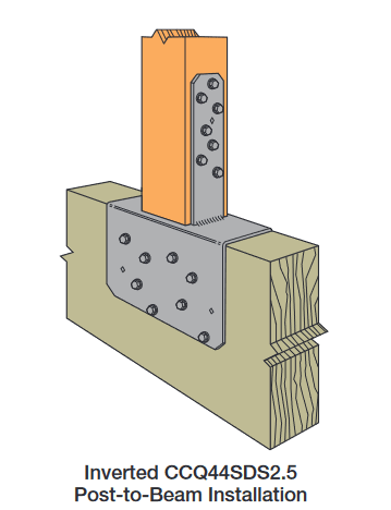

The best option for simplicity is the CCQ connections but they are bulky and also complicate the LVL connections framing into the sides of the 7"x18" LVL. I think I will have to go with that though, unless the HL angles could be feasible somehow (which I don't think they are). I can figure out the side LVL connections with the CCQ in the way.
Well, I did not realize you beam was 7" wide and you uplift was 1,800 lbs. My BC46 idea obvs. will not work then.
I can't think of an easy solution for you other than CCQ connector you show (assuming you can get the correct size).

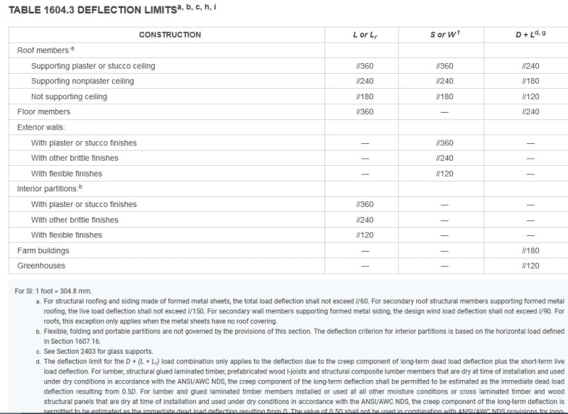

Looks like you are designing for L/240 TL deflection +/-. I usually don't go under L/480 so that is why mine are almost always deflection controlled.
jerseyshore, good thought. Thanks
XR250, is that a code requirement or more of a best practice? I accounted for long term deflections in my L/240 TL and there is no ceiling or anything underneath this LVL.
I feel like it is best practice as, in my experience, LVL's sag more than the calcs would indicate and it prevent call backs.

Furthermore, I assume your 7x18 LVL is actually 4-1.75x18 LVL's? If so and if you are installing along the centerline of the top of the beam, then you would be installing the lag into the planar interface between two LVL's. I would not expect this to behave the same as a solid piece for holding a screw loaded in withdrawal.
All said, I would either contact the LVL manufacturer for guidance on installing lags loaded in withdrawal into the narrow face, or I would look for a way to install fasteners loaded in shear into the wide face.

Is this to be a finished space or an unfinished space (e.g. storage, workshop, etc.). If unfinished space I would definitely go with the CCQ. Personally, I wouldn't mind the appearance of it at all in an unfinished space. If it's to be finished, then simply cover the CCQ with trim, gyp board, etc.

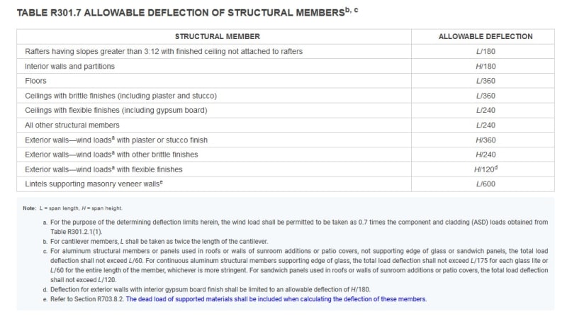

For deflections, I assume the values listed in IRC are for live loads only, except for the masonry lintel. I see it isn't clearly called out though. The values listed in IRC match the values in IBC for L or Lr for the most part. My D and L deflection are each less than L/360 and TL is under L/240 with long term deflection considered. I think I am good to go.
Thanks all.
Remember that those are code minimums. In wood construction, they will almost always lead to problems. Footfall vibrations are a big issue with these 'soft' floors. There's a paper from Virginia Tech on the subject - I think they published as an article in fine home building. They go into a full vibration analysis of a wood floor. They also acknowledge that a level of analysis that high is beyond the budget of most design firms doing houses, and so they recommend designing to a live load deflection of L/480. Some will go a little further and use that for joists, but limit beams to L/600 for live load and L/480 for total load. This results in a stiff floor that is unlikely to make the plates rattle as you walk by the China cabinet.
