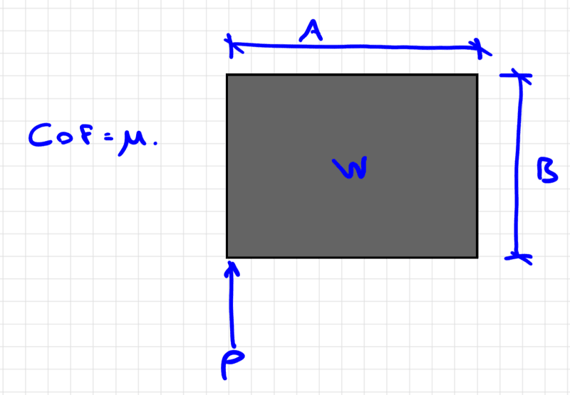

I'm having problems working out when a kentledge block with an eccentric force will slide.
As per image below, say block has plan dimensions of A x B, a weight of W and the sliding force P is applied on the very edge of the block.
I've done a few circles in my thinking now and so far google hasn't yielded anything either!
Any input appreciated!
Martin.

I might be missing something but won’t P= mu * W ?
If P was applied through the centre of mass of the block, then I would agree. But as it's off to the side, there is a tendency to rotate, so I'm thinking some of the friction must be 'used up' resisting the eccentricity.
A bit like the way the stress block under an eccentrically loaded footing is non-uniform. But different in this case, I think, as the friction resistance is uniform over the base.
Martin.
Maybe the answer is to take moments about the far right corner, say:
P x A = W x (A/2) x mu
Martin.

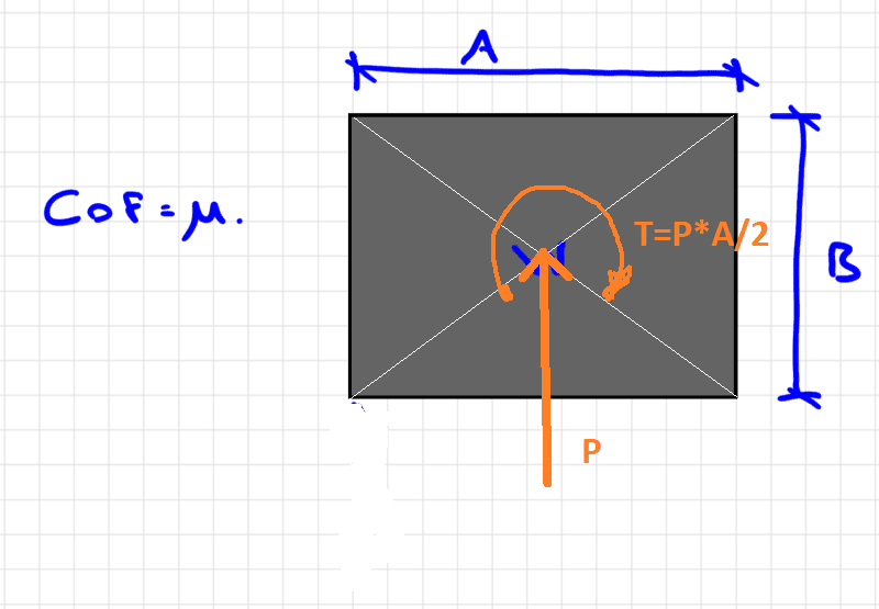

The block will rotate due to the torque developing with T=P*A/2 and slide due to the force P..Of course if the force is great enough to rotate and slide the object..

As soon as the block starts to rotate, the direction of P changes with respect to the block. Eccentricity increases, with a maximum dimension of half the length of the diagonal. The force required to continue rotation and translation diminishes until the diagonal is normal to P.
To calculate the force P required to initiate movement would involve finding the variable frictional stress on the underside of the block due to combined rotation and translation. I think it would be an iterative procedure, beginning with a guess at the location of the instantaneous center of rotation, not an inviting type of calculation.

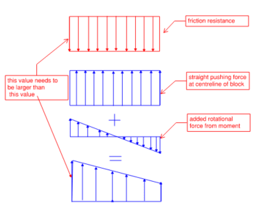

@jayrod,
Are you aware that the sketch in the original post is a plan view?
Yes, I see what you are suggesting. That is beginning to make sense to me.
So movement would start as soon as the maximum stress exceeded μW/AB.
BA

Martin.H said:
That was my first thought, Jayrod, but we're talking about static friction. No movement means no strain, means no stress, so to my mind triangular distributions aren't valid.
Stress on the interface exists even if it is not enough to cause sliding. I think jayrod has a valid concept.
BA
@BAretired, my thought is the block either moves, it doesn't move. The block is rigid, so either all friction is overcome simultaneously (at the same 'stress'), or the block doesn't move.

"No movement means no strain, means no stress" ... why?
the question is what force P will over come the static friction and cause the block to move.
So what Jayrod posted is theoretically reasonable, the unknown is the tapering distribution reacting the torque.
A question is ... is it (the torque reaction) uniform over the block face, or proportional to the distance from the center ?
I guess the next question is does it move the instant static friction is overcome locally ? Could the torque reaction redistribute ??
