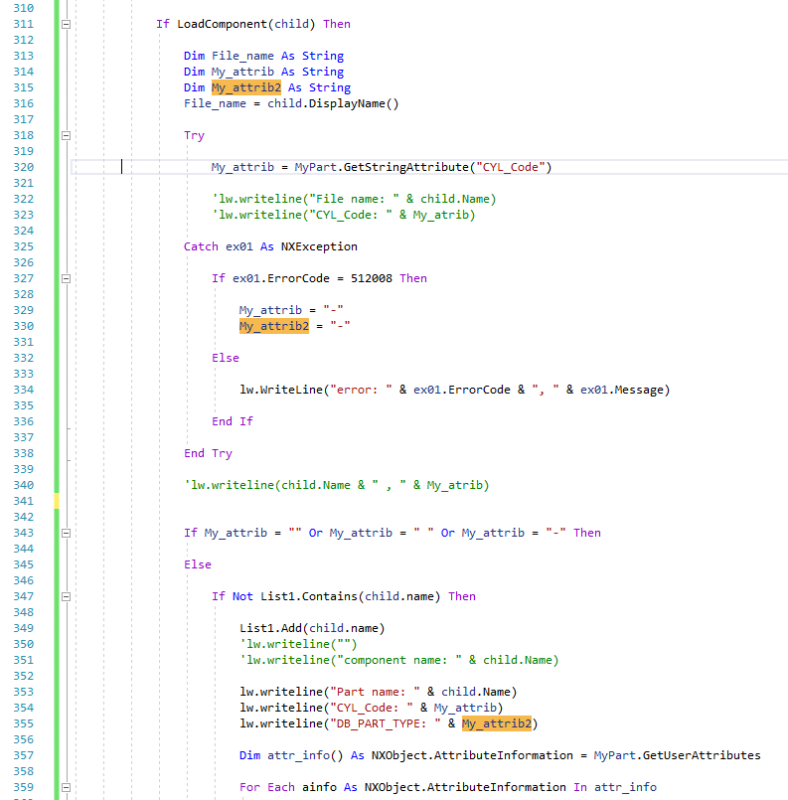

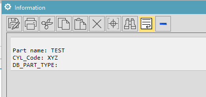

I have been trying to make this work. I have uncommented some LW lines trying to get the info I want to write to a window at least but I cant seem to get the My_Attrib code to display the CYL_CODE attribute string.
I havent tested it, but as I was writing this, I had the thought maybe it is looking for the CYL_CODE attribute in the actual component. What I would need is for it to look for that attribute in the components at the Assembly level. For it is an attribute we only add at the assembly level. Would this be the problem? And could you tell me what i need to change please?
What are values for CYL_CODE? Every file in assembly has this attribute - CYL_CODE or only few of them?
Uncoment this: (after end try)
Code:
'lw.writeline(child.Name & " , " & My_atrib)
and change it to something like this:
Code:
lw.writeline("Part name: " & child.Name)
lw.writeline("CYL_Code: " & My_atrib)
And write if that result is what You need. If so You can delete:
Code:
		if My_attrib = "" or My_attrib = " " or My_attrib = "-" then
		else
			if not list1.contains(child.name) then
				list1.add(child.name)
				lw.writeline("")
				lw.writeline("component name: " & child.Name)
		        Dim attr_info() As NXObject.AttributeInformation = myPart.GetUserAttributes
				For Each ainfo As NXObject.AttributeInformation In attr_info
					'if type is string, do something with the value
					If ainfo.Type = NXObject.AttributeType.String Then
						lw.WriteLine(ainfo.title & " = " & ainfo.StringValue)
						Partlist1.add(new PList1(child.name, ainfo.title, ainfo.StringValue))
					End If
				Next
			end if
		end if
		'lw.writeline("component name: " & child.Name & "-> " & File_name )
		'lw.writeline("")
With best regards
Michael
In playing around with it, I find that it is closer to the correct result without that last code you said to delete.
I was also able to add a second attribute it would list. That is good.
Though the Info Window will list all of the components, it only seems to show the attributes for the components with the CYL_CODE attribute. Which is fine. It would be better I think if it only listed the components with that attribute, but this is fine. You have done so much already.
The only problem however, is for this to work, it seems the attribute "CYL_CODE" must be a part of the actual component file. This attribute will not be in any of the component files but will be added to the components only at the assembly level. Currently this journal does not find those.
I apologize for the hassle and do appreciate your help.

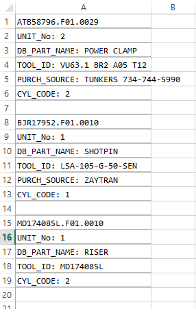

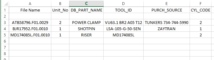

To give you a better understanding of why this is needed....
When our designers model up tools, they will often have different power clamps and hydraulic cylinders they will use. They will be adding the attribute "CYL_CODE" to each cylinder component they have added to their tool. They will fill this attribute out according to the order they open and close when the tool runs. The first clamp to close will get "1", the second to close will get "2" etc...
Someone else here who uses what is called an SDP program, needs to know what order the clamps open and close, so by the designers adding this attribute at the assembly level, we are looking to turn this journal into a way to gather specific attributes for each cylinder or clamp and export the info to excel so she can know which ones open and close first.
I have some code that will export attributes to excel already. Only that exports the work part attributes instead of component attributes. I plan on playing with it and trying to find a way to get it to work with this journal once I get this one returning the right info I need.

Imagine there are two assemblies and both are using the same power clamp component in our library. In either assembly, if you right click on that component and select "properties", you will see all of its attributes.
Now lets say in Assembly "A" you open that components properties and add a new attribute. From assembly "A" you will always see that attribute for that component. But in assembly "B" if you look at its properties, all you will see is its original attributes. You wont see the new attribute.
When we run this code, we need it to look at the components attributes from the assembly level and not the component level.
For instance, I have three components that I have added a CYL_CODE attribute to from my assembly level. These three components have the attribute filled out with "1", "2" and "3". I also created a nothing component I named "TEST" and while I was in that file, I gave it the attribute "CYL_CODE" and filled it in as XYZ. This way I can see where the code is finding the attribute.
Currently this code is finding the TEST with the XYZ attribute, but it does not find any of the components that have the attribute assigned at the assembly level. I need it to look at the components from the assembly level instead of opening them and looking at their original attributes.
As for this new code....
I added the lw.writeline code (As it was giving me a blank window when I ran it) that I am looking for to test if it is working right. I also added a second attribute "My_Attrib2" to the code. I dont think I got this right...
When I run it, I get this result...
Other than the code finds the attribute from the component level and not at the assembly level, I got it to return the second attribute but it doesnt give the attributes result. (Cant think of what you call that part of the attribute). It should be coming back with...
Part name: TEST
CYL_Code: XYZ
DB_PART_TYPE: CORP_tool
And if the code was working for what I need, it would find three more components.
I suppose I should add a second test component with a different attribute result to see if it finds both or just one.
Again, I do apologize for the hassle this is turning into for you and I do appreciate your help.

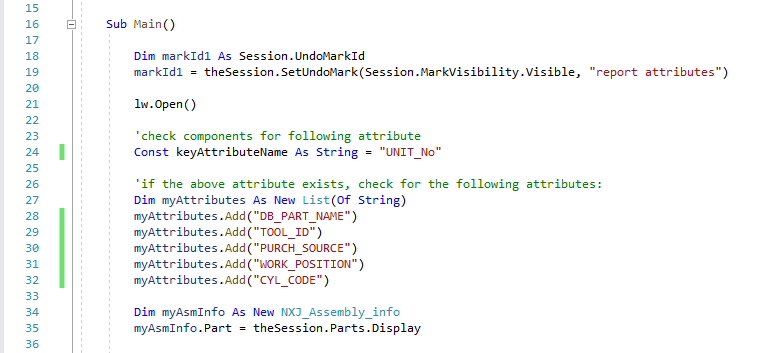

Hey cowski
I updated your journal to gather the attributes I need. 6 of them total. Your code made that very easy. Thanks. lol I really wasnt going to bother you unless I really couldnt figure it out, but since I struggle with the simplest of code, I am figuring that is already a foregone conclusion. lol
I think the easiest way to explain this is through pics.
Currently when I run the journal, I will get this result in the info window....
When I copy and paste it to excel it is like this...
I am told they want the information presented like this... (As it would be easy for them to sort it how they need and not get the information mixed up between components.)
These are the attributes I added to the journal...
If this is something that will take a lot of time, dont worry about it. I could set up an excel sheet to copy the info to and use formulas on a second tab to get arrange it how we want. Im just trying to make this as simple for them as possible when they use it.
Thanks :)
