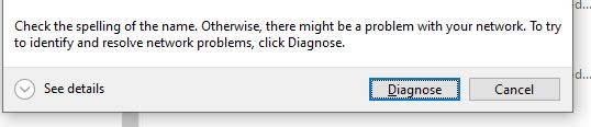

I've just tried it out, but a long path seems to fail.
what I mean is this.... I ran the journal in a large assembly, and the info window pops up, then I open a windows explorer,.... copy the path text, from the info window, paste, into the explorer top line, <enter>.
If the path is long, the explorer errors out, If the path is shorter, it works fine.
So there's nothing wrong with the journal, it must be the windows, window...
But if I have that same location open, in a window, and copy that path, from its top line, and paste THAT into another explorer window <enter>, it doesn't error.
Any idea why this happens??
@moog3,
That's a strange situation. How long is the file path? After running the journal, open notepad and paste the text in there; move your cursor to the end of the line (if necessary) and check the "column" number at the bottom of the notepad window. I think Windows 10 has a soft limit of 260 characters for compatibility reasons.
Also, while you have notepad open, copy the resulting text from notepad and paste it into windows explorer to see if that makes any difference. If it does, it might be a text encoding issue. Notepad defaults to UTF-8 encoding (shown in the bottom right corner), I'm not sure what encoding the NX information window uses.

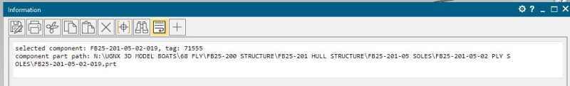

I've noticed what is doing it, (see image)
when the NX window pops up, it puts the end of the path, on another line.
when I highlight the text, copy & paste into the explorer window, It only takes the first line, not the last bit on the second line.
I can fix it, by putting my cursor, at that point in the NX text window, and backspace, to put it back on one line, THEN copy THAT text.
would it be possible to format the NX window to write longer lines?
Unfortunately, it appears that the information window only allows journals to write 132 characters per line. Fortunately, there are several things we can do to circumvent that. The journal below copies the selected component file path to the clipboard so you can just paste it when needed. It also opens windows explorer to the part file. Pick the option that works for you and delete or comment out the others.
