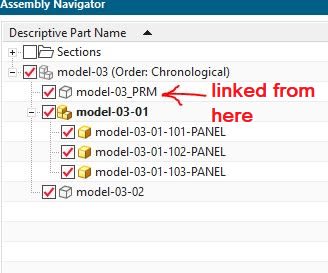

I wonder if you can help me to edit one of the journals in this package.
I like the component creator, but i've been trying to remove the "-PANEL" from the end of the parts created.
Thanks..
I've had success modifying the code, but I'm wondering if ONE more change is possible.
I've managed to remove the "-PANEL" and changed the 101, to 001.
what I'd like to do is, change the scope of the wave link selection to "ENTIRE ASSEMBLY"
My files are such that I need to create SUB assemblies, each with
"created components" in them (for the 2 material types).
My parametric (PRM) file has all the panels, of different materials, I need to add sub assemblies(which I've done) then make THEM the work part, and use the "component creator" to link DOWN from that _PRM file.
therefore the scope needs to be set to "entire assembly"
Once I finish the assembly, I suppress the _PRM file, so its invisible from upper levels of the assembly.
Could someone please help me to achieve this..
If you haven't found the solution yet, look here:
NXJournaling - Adding An Interactive Selection Routine Using SelectObject(...) And SelectObjects(...):
Link
But in short, change the SelectObjects function at the end of the journal. Look for the following line (I haven't checked, but it should work with Wavelink):
Code:
Dim scope As Selection.SelectionScope = Selection.SelectionScope.WorkPart
Code:
Dim scope As Selection.SelectionScope = Selection.SelectionScope.AnyInAssembly
Another solution would be to create the components and simply drag and drop them where you need.
As long as:
Dim wlMakePositionIndependent As Boolean = True
(WaveLink - Make Context-independent - the linked component maintains its associativity after the move)
is set, you are good to go regarding your request. Just double-check their location relative to the original design orientation.
I will make a little tutorial soon about solid body names and how you can set them so the journal can create proper components, but I think we should drive this conversation back to its respective sub where I shared my code:
Other than that, great job editing the journal! I hope this helps with the issue you were trying to achieve.
Thanks for the reply Tamas, this looks like just what I need, i'll give it a go implementing it, if it works, i'll share it back to the other thread you just linked
