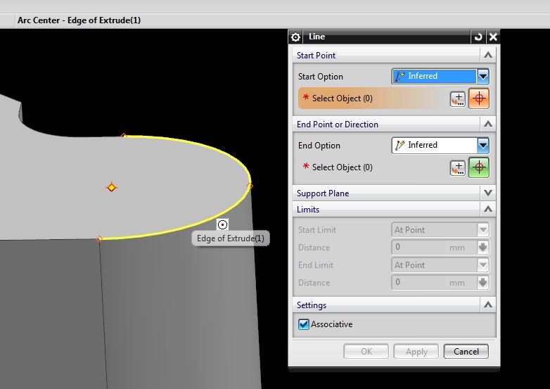

I must transform operation from start point to selected points.
Is is some function in NXOpen for select specific points of geometry (start point, end point or center point) in modeling or manufacturing.
I think about something like this:
I need only coordinates of these points. The rest is simple.

Are you talking about an interactive program (BlockStyler)?
The SpecifyPoint block has a property SnapPointTypesEnabled that allows you to limit the point selection to things like "Arc Center", "End point" etc.

If you want a standalone dialog that lets the user specify a position, you can use NXOpen.UF.Ui.PointConstruct (as you discovered) or Snap.UI.Input.GetPosition.
To allow the user to specify a position on a larger dialog (that includes other items), use a BlockDialog or a BlockForm containing a SpecifyPoint block.
From the text in the first post, I get the impression that you want to select a curve or edge and return multiple points on the curve/edge (such as start point, midpoint, and end point). If this is the case, then yes, there are functions (AskCurveProps being one of them) that will return points on a curve/edge. If this is not what you want, please add some clarification as to what you are trying to do.

I wanted to highlight some points of the model geometry and read their coordinates.
I did this using: ufs.Ui.PointConstruct (cue, base_method, pt_tag, base_pt, response).
