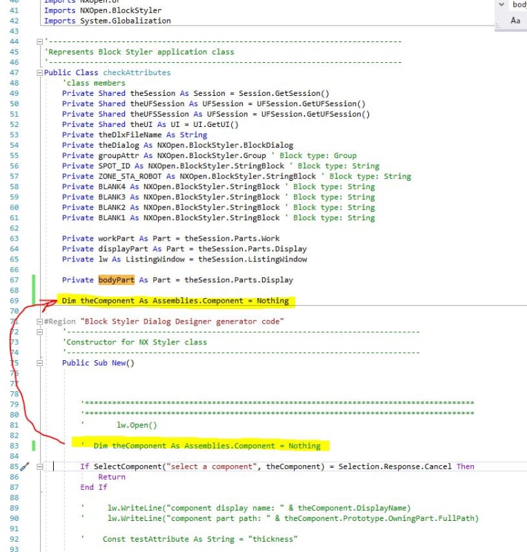

A while back I combined two codes I had and I thought it was working. Nobody ever mentioned it wasnt working right so now that I needed it for myself, I find it isnt working.

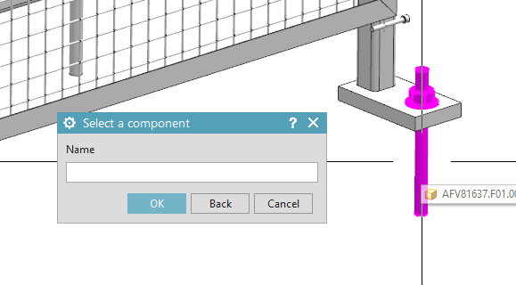

When in an assembly, I want to execute a journal and it will request the user to select a component and hit OK. Then a box will pop-up with certain attributes for the user to fill out. When the user hits OK again, it will add those attributes to that component at the assembly level.

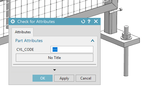

Currently I find this code to request the user to select a component and fill out the attributes, but it is adding the attributes to the assembly properties and not the component properties.
Can someone help me fix this so it adds the attributes to the selected component please?
NOTE**** -- This journal calls a DLX file. I am unsure why this is necessary. It is something someone created for me once. I do know when I have changed this to add different attributes in the past, I had to find them in the DLX file and change them there as well. Both files are attached in a zip folder in case it helps.
This is the Journal code.....
Code:

Public Class checkAttributes
    'class members
    Private Shared theSession As Session = Session.GetSession()
    Private Shared theUFSession As UFSession = UFSession.GetUFSession()
    Private Shared theUFSSession As UFSession = UFSession.GetUFSession()
    Private Shared theUI As UI = UI.GetUI()
    Private theDlxFileName As String
    Private theDialog As NXOpen.BlockStyler.BlockDialog
    Private groupAttr As NXOpen.BlockStyler.Group ' Block type: Group
    Private SPOT_ID As NXOpen.BlockStyler.StringBlock ' Block type: String
    Private ZONE_STA_ROBOT As NXOpen.BlockStyler.StringBlock ' Block type: String
    Private BLANK4 As NXOpen.BlockStyler.StringBlock ' Block type: String
    Private BLANK3 As NXOpen.BlockStyler.StringBlock ' Block type: String
    Private BLANK2 As NXOpen.BlockStyler.StringBlock ' Block type: String
    Private BLANK1 As NXOpen.BlockStyler.StringBlock ' Block type: String
    Private workPart As Part = theSession.Parts.Work
    Private displayPart As Part = theSession.Parts.Display
    Private lw As ListingWindow = theSession.ListingWindow
    Private bodyPart As Part = theSession.Parts.Display
#Region "Block Styler Dialog Designer generator code"
    'Constructor for NX Styler class
    Public Sub New()
        '       lw.Open()
        Dim theComponent As Assemblies.Component = Nothing
        If SelectComponent("select a component", theComponent) = Selection.Response.Cancel Then
            Return
        End If

    Function SelectComponent(ByVal prompt As String, ByRef selObj As TaggedObject) As Selection.Response
        Dim theUI As UI = UI.GetUI
        Dim title As String = "Select a component"
        Dim includeFeatures As Boolean = False
        Dim keepHighlighted As Boolean = False
        Dim selAction As Selection.SelectionAction = Selection.SelectionAction.ClearAndEnableSpecific
        Dim cursor As Point3d
        Dim scope As Selection.SelectionScope = Selection.SelectionScope.AnyInAssembly
        Dim selectionMask_array(0) As Selection.MaskTriple
        With selectionMask_array(0)
            .Type = UFConstants.UF_component_type
            .Subtype = UFConstants.UF_component_subtype
        End With
        Dim resp As Selection.Response = theUI.SelectionManager.SelectTaggedObject(prompt,
        title, scope, selAction,
        includeFeatures, keepHighlighted, selectionMask_array,
        selObj, cursor)
        If resp = Selection.Response.ObjectSelected OrElse resp = Selection.Response.ObjectSelectedByName Then
            Return Selection.Response.Ok
        Else
            Return Selection.Response.Cancel
        End If
    End Function

    Public Sub dialogShown_cb()
        Try
            '---- Enter your callback code here -----
            SPOT_ID.Value = readAttribute(workPart, "SPOT_ID")
            If SPOT_ID.Value = "" Then SPOT_ID.Value = "---"

 https://files.engineering.com/getfile.aspx?folder=2759c59f-f2e4-4514-8e93-f2a08a3f1233&file=Cylinder_Attributes.zip
Cowski, once helped me with this problem, or a near identical problem on and old thread. This was the advice he gave me....
Cowski said:
The function "apply_cb" calls the "createAttribute" sub and passes in "bodyPart" as the target; "bodyPart" is just another reference to the current display part (most likely your top level assembly). In these calls to "createAttribute", you will need to pass in your component of interest. Which leads us to the component variable: "theComponent" is currently declared inside of sub "New", which means when sub New is done executing, "theComponent" will go out of scope and will no longer be available for use. I suggest moving the variable declaration to the 'class member' section (after the class declaration, but before Sub New); this will make it available anywhere in the class. Keep the call to "SelectComponent" where it is in Sub New.
My guess is I messed up somewhere. I am thinking it is in this instruction.....
As I suck with code, in being honest, I dont know what "variable declaration" is. So I am thinking I must not have done this part? Can someone explain that to me better?
I think this might be what I was supposed to do??....
Unfortunately it did not fix the problem. So I am guessing I didnt get it right. lol

Found the problem!
In this function....
Public Function apply_cb() As Integer
I had to change....
theObjects(0) = bodyPart
to
theObjects(0) = theComponent
Once I did that and ran the code, it added the attribute to the component at the assembly level just as I wanted.
Though I have figured out the original problem, there is still a couple minor issues I would like to fix if anyone could please tell me how.
Currently when I hit my button, the first box will appear and I will select the component and hit OK....
However, two things are happening that are not a big deal but I would like to fix them if I can.
1) The component does not stay highlighted. I would prefer it stayed highlighted until the second box has the OK clicked.
2) If the component already has the attribute, it still shows "---" in the box. I would prefer it showed what the component already had filled out for that attribute. This way the user will know if it is done already.
If anyone can help with either of these, I would appreciate it.
If it helps, I have found that the code is looking for the attribute in the assembly instead of the selected part. I just havent figured out how to change it to find the attribute in the selected component.
My guess is it is in one of these two sections of code....
I keep looking at the first part, where it says "workpart", thinking it should say "selPart" or something, but nothing I try works.
	Dim MyPart As NXOpen.Part = Nothing
    Public Sub New()
        '       lw.Open()
            Return
        End If
        End With
        Dim resp As Selection.Response = theUI.SelectionManager.SelectTaggedObject(prompt, title, scope, selAction, includeFeatures, keepHighlighted, selectionMask_array, selObj, cursor)
        Else
        End If
    End Function
        Try
            SPOT_ID.Value = readAttribute(MyPart, "SPOT_ID")
            ZONE_STA_ROBOT.Value = readAttribute(MyPart, "ZONE_STA_ROBOT")
            If ZONE_STA_ROBOT.Value = "" Then ZONE_STA_ROBOT.Value = "---"
            BLANK4.Value = readAttribute(MyPart, "BLANK4")
            If BLANK4.Value = "" Then BLANK4.Value = "---"
            BLANK3.Value = readAttribute(MyPart, "BLANK3")
            If BLANK3.Value = "" Then BLANK3.Value = "---"
            BLANK2.Value = readAttribute(MyPart, "BLANK2")
            If BLANK2.Value = "" Then BLANK2.Value = "---"
            BLANK1.Value = readAttribute(MyPart, "BLANK1")
            If BLANK1.Value = "" Then BLANK1.Value = "---"
        Catch ex As Exception
            '---- Enter your exception handling code here -----
            theUI.NXMessageBox.Show("Check Attributes", NXMessageBox.DialogType.Error, ex.ToString)
        End Try
    End Sub
        Dim errorCode As Integer = 0
        Try
            If SPOT_ID.Value.ToUpper = "---" Then SPOT_ID.Value = ""
            If ZONE_STA_ROBOT.Value.ToUpper = "---" Then ZONE_STA_ROBOT.Value = ""
            If BLANK4.Value.ToUpper = "---" Then BLANK4.Value = ""
            If BLANK3.Value.ToUpper = "---" Then BLANK3.Value = ""
            If BLANK2.Value.ToUpper = "---" Then BLANK2.Value = ""
            If BLANK1.Value.ToUpper = "---" Then BLANK1.Value = ""
            Dim theObjects(0) As NXObject
            'theObjects(0) = bodyPart
            'createAttribute(MyPart, theObjects, "SPOT_ID", SPOT_ID.Value)
			'createAttribute(MyPart, theObjects, "ZONE_STA_ROBOT", ZONE_STA_ROBOT.Value)
            'createAttribute(MyPart, theObjects, "BLANK4", BLANK4.Value)
            'createAttribute(MyPart, theObjects, "BLANK3", BLANK3.Value)
            'createAttribute(MyPart, theObjects, "BLANK2", BLANK2.Value)
            'createAttribute(MyPart, theObjects, "BLANK1", BLANK1.Value)
			MyPart.SetUserAttribute("SPOT_ID", -1, SPOT_ID.Value, Update.Option.Now)
			MyPart.SetUserAttribute("ZONE_STA_ROBOT", -1, ZONE_STA_ROBOT.Value, Update.Option.Now)
			MyPart.SetUserAttribute("BLANK4", -1, BLANK4.Value, Update.Option.Now)
			MyPart.SetUserAttribute("BLANK3", -1, BLANK3.Value, Update.Option.Now)
			MyPart.SetUserAttribute("BLANK2", -1, BLANK2.Value, Update.Option.Now)
			MyPart.SetUserAttribute("BLANK1", -1, BLANK1.Value, Update.Option.Now)
            errorCode = 1
        End Try
        apply_cb = errorCode
    End Function

I made the changes I needed to add the correct attributes now that I have more info from others. lol This works great.
I do have a question though and if it is a big change, dont worry about it. Currently, after filling out the attributes, if one hits "APPLY", that box stays open. This would never be needed as we would always need to select another component. Is there a simple way to make the "APPLY" button start the entire process over?
The user would hit the button to start the journal. It will ask him to select a component. He will select one and hit OK. Then it will pop up with a box with attributes to fill out, just as it all works right now. But after filling the attributes out, he could hit OK and it goes away, or he could hit Apply and it would start over asking him to select the next component.
The closest thing I could find on the internet to this was called recursion or something like that, but I didnt understand how it worked or if it was what I needed. My problem is that I am given a job where I need to do something with Journals once every so many months only. So every time I come back to it, I feel like I am learning it all over again.
These days my brain is a sponge. A sopping wet sponge. When I use it, it seems I lose more information than I soak in.
As I said, this isnt important as it is only the difference of having to hit a button again to do the next component.

    'Callback Name: ok_cb
    Public Function ok_cb() As Integer
        Try
            'errorCode = apply_cb()
            errorCode = 1
        End Try
        ok_cb = errorCode
    End Function

Hey niedzviedz;
I have come across a major issue with this code.
Not sure how familiar you are with automotive tooling, but we will create assemblies we call units. One complete tool will have multiple units in it. So basically we can have anywhere from 2 to 50 assemblies that will build up one top level assembly. The top level assembly is called the key sheet and all the assemblies inside that key sheet are called units.
In this particular case, we have a keysheet that is made up of 30 units. We might have ten instances of the same power clamp being used within those units. The designer needs to add two particular attributes to each instance separately. This way we can list what Unit it is found in and which order the cylinders activate.
Currently, if I use this code to give a single instance of a component these attributes, it is giving it to all instances of the component used in all the units. I need it to only give it to the instance of the component that is selected.
When you get time, could you please help me with this?
Also, I have updated the code so it now adds the attributes we need. When we started this, I didnt have that info yet and we were working with examples. I am attaching a zip with the current code and the DLX file it calls.
Sorry for the hassle and thanks
Ken
My brain is like a sponge. A sopping wet sponge. When I use it, I seem to lose more than I soak in.
Try this code:
		Dim resp As Selection.Response = Selection.Response.Cancel
		End With
		'Dim resp As Selection.Response = theUI.SelectionManager.SelectTaggedObject(prompt, title, scope, selAction, includeFeatures, keepHighlighted, selectionMask_array, selObj, cursor)
		resp = theUI.SelectionManager.SelectTaggedObject(prompt, title, scope, selAction, includeFeatures, keepHighlighted, selectionMask_array, selObj, cursor)
		If resp = Selection.Response.ObjectSelected Or resp = Selection.Response.ObjectSelectedByName Then
		Else
		End If
	End Function

So it turns out this code is doing something funky that doesnt make sense to me.
I was trying to figure out how to keep the parts highlighted even if you select "APPLY" and wait until someone hits "OK" or "CANCEL" before they unhighlighted (I was trying not to hassle anyone for that), when I noticed this problem during testing.
I added attributes like this...
Component1 = 1111
hit apply
Component2 = 2222
hit apply
Component3 = 3333
hit apply
Component4 = 4444
hit OK
Then going back and checking the components, I get the following results.
Component1 =
Component2 = 1111
Component3 = 2222
Component4 = 4444
It seems to ignore the first component and add its attributes to the next component and then overrides the second to last set of attributes and adds the correct attributes for the component I select OK on.
Just to be clear, I was playing with a copy of the code. I went to the original code and tried it and got the same results.
Ken
Just an update. I have found a way to fix the highlighting problem at least.
I changed this code in the SelectComponent function to "True"
Code:
 Dim keepHighlighted As Boolean = True
This kept it all highlighted but didnt unhighlight the components after I hit OK. So recorded a part cleanup with the unhighlight optioned turned on and used some code from that and added it to the public Sub Dispose code...
Code:
    Public Sub Dispose()
        If theDialog IsNot Nothing Then
            theDialog.Dispose()
            theDialog = Nothing
            displayPart.Views.Refresh()
            theSession.Parts.SetWork(workPart)
            Dim partCleanup1 As NXOpen.PartCleanup = Nothing
            partCleanup1 = theSession.NewPartCleanup()
            partCleanup1.TurnOffHighlighting = True
            partCleanup1.DoCleanup()
            partCleanup1.Dispose()
        End If
    End Sub
Likely there is a better way. This seems to add a few seconds of run time to the code after I hit OK, but at least it works. Believe it or not, this is a huge accomplishment for me when it comes to code. lol
Ken
The Power of Prayer! I have been trying to figure this out for days and growing frustrated. I prayed at lunch and just figured it out. :)
I cant believe how easy it was to fix too.
I only had to move this code...
Code:
response1 = SelectComponent("select a component", theComponent)
and place it right after....
Code:
Dim nXObject3 As NXObject
nXObject3 = attributePropertiesBuilder2.Commit()
attributePropertiesBuilder2.Destroy()
Now there is only one last thing I need to do with this journal. Get it so when I select a component and the box appears to fill out the attributes, if it already has these attributes they want it to show those attributes. This way the user will know if it was already done.
Ken
And it is complete. I have had a good day! lol
For this last part, all I had to do was change "selPart" to "theComponent" in two places within the "readAttribute" function.
What doesnt make sense to me is that in the top line....
Code:
Private Function readAttribute(ByVal selPart As Part, ByVal attrName As String) As String
I had to leave it as "selPart" for it to work. Even though that is the only place in the journal "selPart" shows up.
But it works and I am happy. lol
