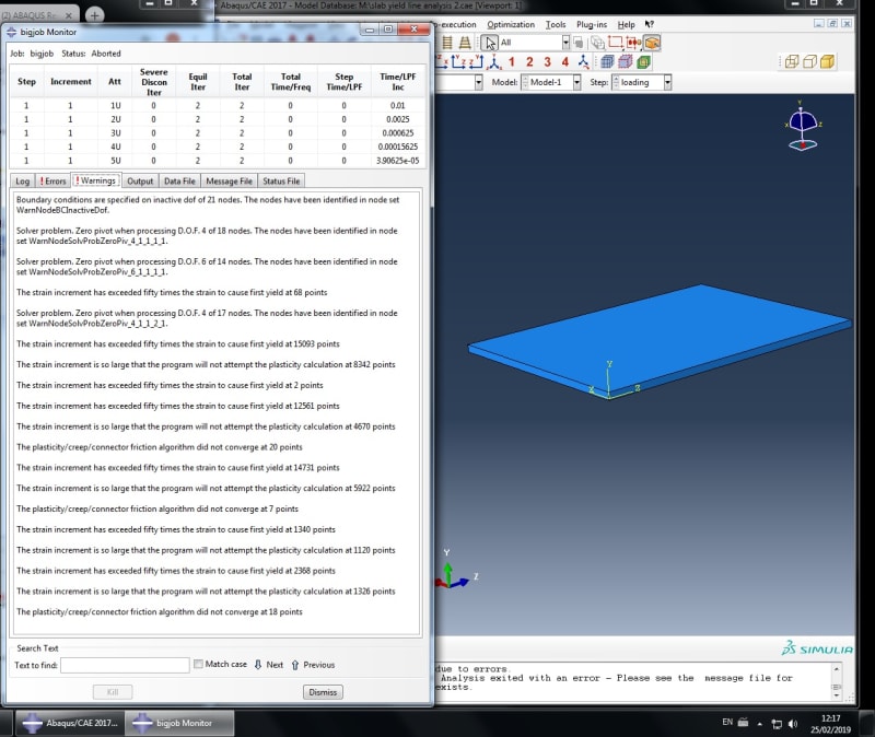

I have tried to make a fresh model and this is what happens
Zero pivot error - clear sign that something is underconstrained (you can view these nodes as suggested in the error message). One encastre for the slab is enough so it must be about the beams. You should fix them like you would if they were analyzed without the slab. If you can’t select them because they are inside the slab then just hide the slab using diplay group options.
Also you can perform eigenfrequency extraction analysis. Rigid body modes will appear at near zero frequency and you will be able to see which part of the model is underconstrained.
I fixed the rebar on the ends and it hard finally worked!!!
Thank you for your help! very much appreciated
