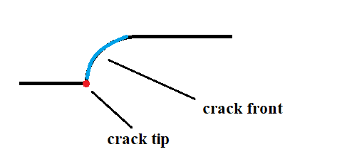

I am trying to model a C(T) specimen to derive the resistance curve from it. As it can be seen from the figure above, I have modeled it considering a non-sharp crack with crack front defined by the row of elements ahead of the pre-crack tip. The growth is simulated by element deletion considering a damage evolution law (GTN model, in abaqus known as porous metal plasticity).
I want to obtain the J-Integral values for each time step so I can derive the J-Δa curve. How could that be done in Abaqus? What woyld be the most easy and straightforward way to do it?

In Abaqus you can request J-integral and stress intensity factor output for analyses with stationary cracks (using either regular FEM or XFEM). But you have to define crack first (Special —> Crack —> Create).
Hi FEA way
That would work only for a seam crack, i.e., a sharp crack with front defined as a line or point. As I explained, I am trying to make a more "real" crack front considering it a non-sharp (blunt) crack. For that, I do not know how to proceed.
If anyone could give me some help, I'd appreciate it. Thanks
It's possible to analyze blunt cracks this way too. In such case you should select the blunted notch surface as crack front.
For crack tip you have to select nodes at the actual tip of the crack. Here's how it should look like for rounded crack (modeled using symmetry):

It seems that contour integral does not work with Explicit. Any ideas on how to work this around?
Yes, you have to use Standard (implicit) for that. There’s no option to evaluate J-integral and SIF’s in dynamic explicit analysis. So you would have to change solver.
