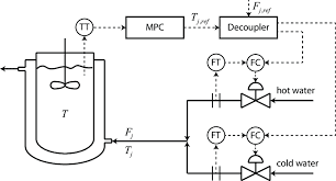

Hi, is there a COTS item to heat/cool/maintain the temperature a body of water?
The water volume is approx 3-400 litres, and temps held within approx 10-30 degrees C.
Can anyone think of something which might suit the need?
Thanks.

Generically, this is one way:

Thanks for the link and image, Mint. That’s the sort of thing I’m chasing.
Ambient temp is weather dependent, generally 10-25C. Static body of water. If it takes 12 hours to equalise the temp, that’s not a big issue.
Acceptable tolerance is quite large, likely to be +/- a degree (C). The quotes temps were approx max and min temps.

Measured where? At one point, selected for a reason? At any arbitrary point? "Everywhere". Is this an average, or a uniformity requirement?
If you are relying on natural convection currents for mixing, then the "body" shape and design of the heating and cooling elements becomes super important.
You've almost provided enough information to start calculating the power and energy requirements. With tank (if it is a tank) geometry and insulation you could have a ballpark calculation for both.
So if your acceptable range is 10 to 30 C and ambient temp is 10 to 25 C why do you need anything? The assumption is that there is something which either generated heat or uses heat in this water bath but you're not telling us what it is or how much energy is involved.
