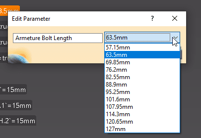

I want to create a User Feature that has a drop down box, with pre-populated values. Great for start parts. I was thinking that it would be super simple to use a series of design tables for this. However, I've not come up with a good way to do this. The design table is immediately in conflict with the 'multiple values' aspect of the parameter that it's supposed to populate.
So can anyone tell me if you have a way to do this? Summary:
1) create a design table with all possible values
2) link the values in the design table, to the multi-valued parameter
3) expose the multi-valued parameter to the User Feature. (no custom variables - only admin defined)
Of course, I'm open to other suggestions. This was just my vision.

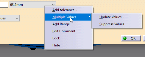

I thought about it and maybe you can skip the design table completely and just make several parameters in the tree to control your values. You defiantly can make drop downs there and also have the power to create values based on formulas as you see fit.
When you create a new parameter, just select multiple values
You can also edit by right click or change a different existing parameter to multi-value also.
Getting the multiple values is the easy part. What I want, is to have the option to select from a list of multiple values upon instantiation. Since User Features are black boxed, this would prevent switching the configuration post-instantiation. Which makes perfect sense when you create parts from cut stock, and have no use case for re-using a part number.
