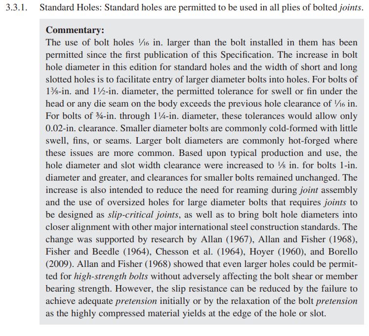

BTW in case you haven't seen it AISC / RCSC have jointly published quite a nice commentary (for free) on latest measures for joints using high strength bolts. Can be found here.
Here's their commentary on the change from 1/16" tolerance to 1/8"
IMO, using an industry standard size hole does not mean that there will be more deflection. I think a lot of the statements above assume that all plies of the connection have perfectly matching holes and that the bolts are perfectly straight, perfectly round, and exactly 1" in diameter. There are tolerances for all these different components. Galvanizing the bolts changes things too. In reality, some bolts will initially be in bearing and others may not, but detailing per industry standards helps ensure that the pieces will bolt up and perform as expected. Seems to me the EOR is specifying something that may not bolt up.
With that said, I'm no expert in how all these tolerances work together. I do know that a lot of time and deliberation goes into the developing these industry standards. The committees consist of producers, fabricators, detailers, erectors, engineers, academics, etc. I am hesitant to spec something more stringent without first understanding why the industry standard is what it is. Chesterton's fence comes to mind...
jorton - I love that. Good read. I was unaware of it before now, but I think it cuts both ways and sums up my point nicely as well. The EOR decided they want 1-1/16" holes or slip critical connections. They may not be right, but it's their call and the result is theirs to own - and maybe the framing in question was already designed to L/361 deflection and the added slip (if it occurs) will bring them down to L/350 and it'll violate serviceability requirements for the space. We don't know what the EOR's reasoning is, so we shouldn't insist on changing it without first understanding it.
