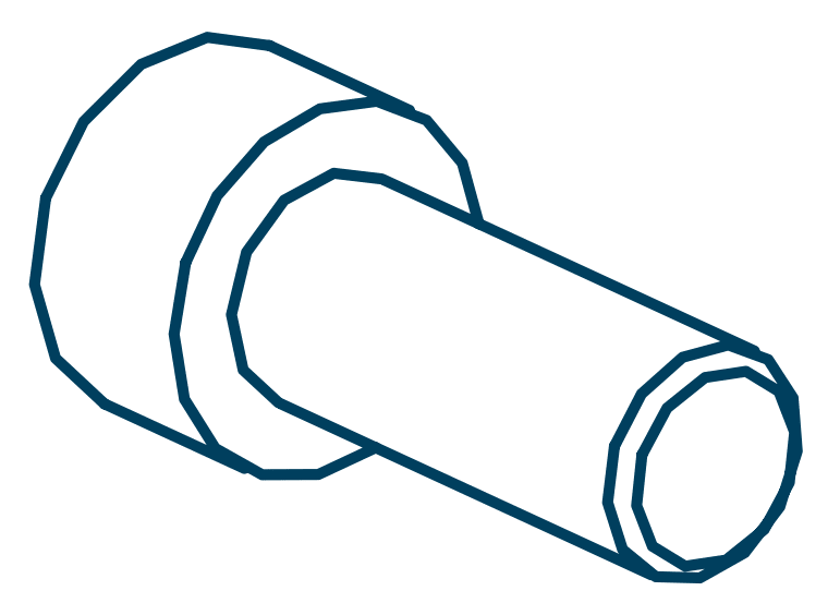

hi friends
i cant find any option or setting for controlling line quality for PDF export. seems anti-aliasing is not take into account.
the problem is that for "pictorial views" NX breaks non-rectilinear curves into poly-lines and results in jagged curves in generated PDF. this problem matters when i face with "Big exploded views" and creates illustrations difficulties in some view scales.
previously i used to be work with solidworks and there was options for curve qualities.
im looking for smooth curves in pictorials. can someone help me please?
NX 12

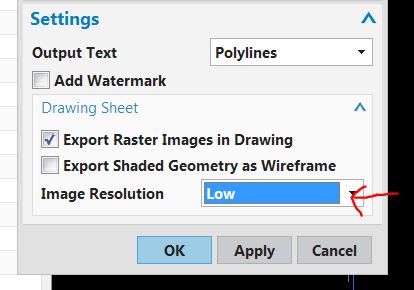

Does changing the image resolution under Setting on PDF export option help? or it is still the same?

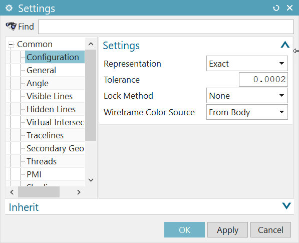

Double-clicked the exploded view. The settings window will pop up. Under Common=>Configuration. Set the Representation to Exact. If set to smart lightweight, the exported PDF would have image quality like the one you mentioned.

i used your instruction but the problem remains.
and with the above setting results is depicted image.

Then any drawing views that you created in NX drafting, you should be able to edit the view.
Where you can set the representation to Exact. When the drawing is exported out as PDF, it would be ok.

Actually, I asked for provide an exploded view in PDF format that can be used for downstream presentation purpose. So because of huge number of components I reduced the view scale that can be fit in paper (A1 landscape). after zooming on screen, accidentally I noticed strange illustration about arcs and circles in PICTORIAL views. Seems NX converts non-rectilinear curves to POLYLINES in pictorial views. this is not about specific drawing.
also there is no problem on prints but I was searching for tweak this issue if it’s possible.
