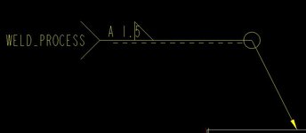

Mar 20, 2014 #1 S saspinall Guest Hi Anyone else having trouble with the ptc standard ISo weld symbol and there not being enough room, even for the fillet size... Do you have to modify the symbol, redefine symbol etc See attached.. Thanks Stuart Attachments Capture.JPG 24.5 KB · Views: 22

Mar 24, 2014 Thread starter #3 K KK_designer Guest see link: http://www.mcadcentral.com/creo-drawing/9703-symbol-creati-n.html for info But if you need something to move go to format- symbol galery- redefine- pick the symbol and try little bit to move and see what happen

Mar 24, 2014 Thread starter #4 R rebo2610 Guest I've seen it when I try to use a fraction - there is a set number of characters allowed. PTC should make it variable and move the fillet symbol over as required.

Mar 24, 2014 Thread starter #5 S saspinall Guest Thanks...looks like I'll have to redefine the standard ones and create our own weld symbol library.... Stu
