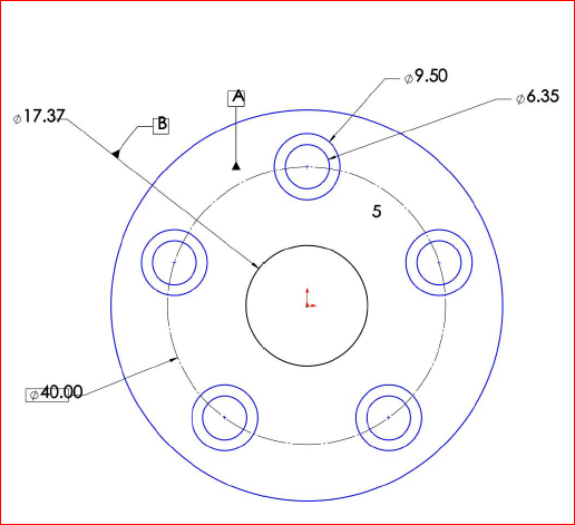

Q: Has ISO updated its simultaneous requirement definition from 1998 to 2016?
Background: One position (5 holes) has double CZ modifiers and one SIM and the second position (4 holes) has CZ and SZ and also one SIM. Same datums on both. Is simultaneous requirement implied for both sets of holes?
For my life I am not understanding those callouts.
I need some basic understanding of the simultaneous requirements in ISO. Any good discussions to point out to?
What I knew (until today) is CZ = simultaneous requirement in ISO.

Please do not use “unless otherwise specified”. It is a GDT “offensive”, under defined and debatable term. [banghead] [bigsmile]
Kedu,
Yes, ISO approach is totally different than what is in ASME. And you actually summed it up very nicely: "Everything independent unless otherwise specified."
I am not sure if legal, but I would definitely say it is not the best idea to use draft version of the standard in any communication betweeen customer and supplier, especially if one of the parties does not have access to the document. This may lead to different issues and this discussion actually proves it.
But as you said, this is just a draft of the drawing, and that is why I suggested you should simply ask the customer to provide you with information necessary to interpret the callouts.
