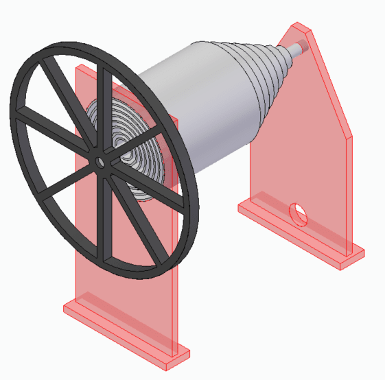

Is it possible to design a system of multiple, independently rotating, concentric (up to 9 shafts)? The inner most shaft must be at least 75mm dia and the rpm between each layer will be 125 at the peak. Leaving out manufacturing and tolerancing difficulties for now, are there any ways to accomplish something like this other than putting a ball bearing between each layer? Has anyone seen similar builds?
Any insight would be appreciated.

Plain bearings were the first alternative that came to mind, I just worry about the durability and maintenance of such a system. A little more information about the machinery in question:
The center shaft will be driving a large diameter cantilevered carousel, each concentric shaft from there on would be used to drive individual elements that ride along the outside of the carousel. These individual elements (8 total) need to be accelerated and decelerated as they rotate with the carousel for process purposes. Currently this is done with a traditional mechanical cam and link design but I am looking for something with greater flexibility and quicker size change. Each of the outer shafts would be driven independently so that the cam can be done through the program instead of mechanically. We've had success with this concept for a 2 shaft system, but that was done using a right angle gearbox designed for such an application and is not available in enough sizes to accommodate 7 more shafts.
In case you are wondering, as I was the first time I saw this, the only reason the carousel itself is spinning is because the outer races that the 8 elements ride along wear too quickly if it is stationary.
Here is a quick 3D cartoon I made to help with visualization. The elements along the carousel are not shown, nor are the links between them and the outer shafts.

Thanks for all the responses and insight, truly appreciated. That 3-d cartoon is missing a lot of detail that I didn't have time to put in so I'll do my best to describe what is missing for now and maybe I'll go back and add some detail to the model if I find the time.
Scale: The inner most shaft is shown at 75mm dia (based off of the unit I am looking to replace) and the outermost layer is 675mm dia.
Drive: Each layer of this system will be driven independently which is why they are tiered on the back end. Each layer will get its own belt drive to a servo for independent control (to allow for fully programmed control of the cam).
Linkage to the elements on the carousel: The individual elements residing on the perimeter of the carousel and the linkage to the concentric shafts are not shown, but the idea is to accelerate and decelerate them as they rotate along with the carousel, which will rotate at a constant rpm. So if you imagine the carousel is running at 0 rpm the concentric shafts would simply oscillate back and forth.
Roller element bearings: This is what I first envisioned for the system but in my searching I was unable to find bearing that would be large enough in diameter for the outer layers, small enough profile to avoid adding excess girth to the overall assembly, and rated above 125 rpm. If anyone has suggestions for a supplier or product line I'd be all ears.
