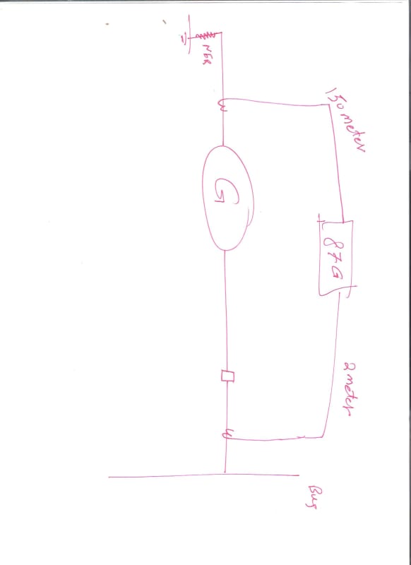

Dears,
how we can compensate for different length in differential secondary circuit (Gen neutral CTs is 150Meter and CB CTs just 2Meter) see attached Pic

newelecteng,
Quote "how we can compensate for different length in differential secondary circuit (Gen neutral CTs is 150Meter and CB CTs just 2Meter) see attached Pic" Unquote
All that is part of pickup threshold and bias setting calculations, meaning the lead mismatch errors, errors due to CT parameter mismatch etc. can be compensated by choosing appropriate settings.
newelecteng said:
and I few assume CT saturated the 87G should be stable.
I think you're saying you're suprised that the generator differential (87G) would trip due to CT saturation. You shouldn't be. If a line CT doesn't go into saturation at exactly the same time as the corresponding neutral CT, that creates a mismatch on the CT outputs which the differential interprets as a fault within its zone.
I think the problem is secondary path of gen neutral CTs is much larger that path of Cts near CB that they feed the 87G. Can this cause unequal saturation !!
The length plays a role to the extent it contributes to the burden that helps push the CT into saturation. The first priority it to avoid saturation on through-currents in order to avoid differential trip. But if you don't meet that and find yourself in undesirable situation where a CT reaches saturation then I think there might be some benefit to trying to balance the burdens on both line and neutral CT's (assuming they're identical). I'm recalling back in the distant past some resistors were added to our generator differential circuits in order to solve a problem with generator differential trip during fault outside the zone. I don't think it is a standard / preferred design practice but it did resolve the issue.
(2B)+(2B)' ?
I've seen an SA-1 generator relay misop due to a wide sync angle on a local breaker (not the generator breaker). When that breaker closed, the local angle jerked significantly enough to cause a largish inrush into the generator. There was a recommendation from ABB to add a desensitizing resistor on them at one point in time and that was never done. Your relay may be susceptible to similar transient issues.
