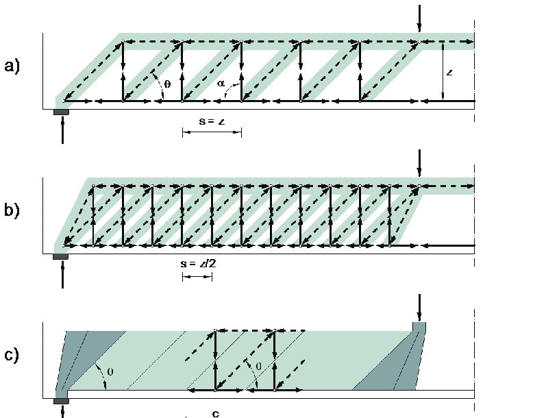

1- A member subjected to given loading is treated as a space truss formed by a series of joined planar trusses.
2- The concrete member reinforced with longitudinal and transverse reinforcement resists shear/torsion by producing a circulatory shear flow at the outermost part of the beam cross-section. Thats why using steel rebars are preferred at circumferential surface of beam (with a nominal cover of 25-50mm.

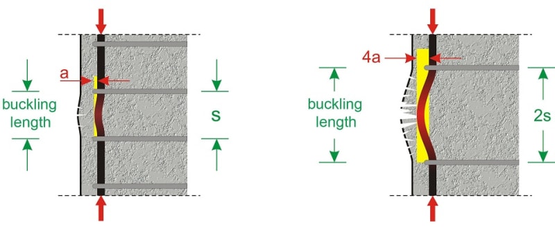

3- Also the concept of concrete confinement is will suited/played if steel truss is distributed at circumferential surface of beam.

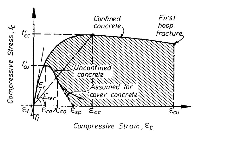

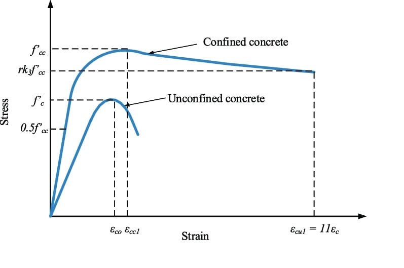

Confined and confined unconfined concrete terminology, benefits shown in attached curves.

look at following paper, and also the concept of space truss [Mörsch's truss analogy model]

"It has a small advantage in confinement also."
could you elaborate ?
my interpterion of confinement is similar to following
@ BridgeSmith
I was referring to confinement of the concrete - having the bars farther out puts a little more concrete inside the bars. The difference would be minimal, and the necessity probably non-existent, in most cases.
Placing longitudinal bars in the corners of beam stirrups is an ACI 318 code requirement to ensure (near) instantaneous tension development of the stirrups. See ACI 318-08 Section 12.13.2. (I don't have my ACI 318-19 handy with me, but I don't think it's changed.)
