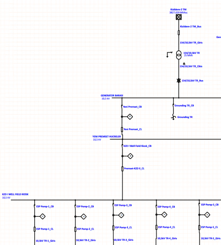

Hi Everyone,
I have isolated system which has 154kv/10.5kv YN/D transformer. I have to do protection for delta side of this system. In case of earth fault, I know that I can not protect my system with current. I should use 59N protection. In case of earth fault in any bus in our system, unfaulted phases voltage will be increase for all buses. But in this case how can I localize the faulted part of system.

Hi Guys,
Thank you very much for your reply.
Actually, at the beginning of project this site has 20MVA generator (Yn) and 20MVA (YND) step up transformer which is produce electricity for the grid. Then customer informed us, he will shutdown his generator and he will use this transformer just for pump the hot water for the another power plant which is located 1 km away from existing power plant.That is why, without his knowledge their system become IT system.
But pump motors are 2 km far away from 20MVA transformer. That is why if I put earthing transformer with hing impedance which is limit 5-10 Amp, I will not able to sense ground fault again. I am planing to limit short circuit current around 1ka-2ka, after discussion with out transformer factory. Do you have any opinion about impedance of earthing transformer ? or is there any missing part that I do not understand ?
Thanks for you patience and support.

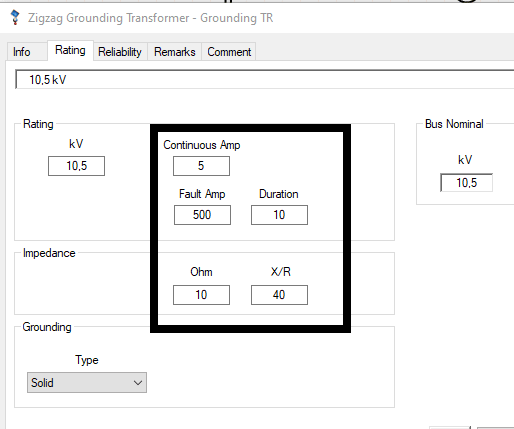

Please also let you explain about below Etap screenshot. PS: I am trying to limit grounding current around 1kA and I will use zigzag transformer. Should I add also, neutral resistor for this application ? If it is possible could you explain me how can I calculate those vaules ?
Continuous Amp= What is it ? As much as I understand this value should determine according to unbalance condition..
Fault Amp = This value represent the current which is passing through artificial neutral point or one phase winding of zigzag transformer during fault condition ?
Ohm= I think, this one is reactance of per phase. As much as I have searched from google, reactance of grounding transformer is really high if I compare with normal power or dist. transformer reactance. I am not expert but as I know reactance of those transformer around mohm. So, if I mention transformer manufacturer, can they adjust the reactance of winding, what I want to limit faulty current ??
X/R = How can I determine it or tell the transformer manufacturer ?
May be those question a bit silly but I would like to learn it.. :)
It does account for unbalance conditions. Typical value: 10% of the transient current (but this is conservative, standards may recommend lower values).
Typically the rating is for the neutral current but here it depends on ETAP (I don't use it, so I can't help with this).
Once you specified the ground current limit, the impedance of the earthing transformer it's already defined (if there is no additional resistance, at least):
z0 = ( 1.73 x VL-L) / I ground-fault = 57.16 ohm (for the 1kA current, if I did it right). And yes, is a per phase impedance.
Hope it helps.
