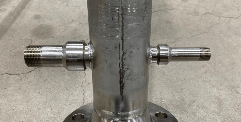

The minimum weld required for olet to run pipe as described below as per ASME 31.3, but if same followed for SS run pipe , there be distortion.
so is there any excuse for SS olet welding.
328.5.4 Welded Branch Connections
(i) Figure 328.5.4F shows additional integrally reinforced branch connections typical of MSS SP-97 fittings that abut the outside of the run attached by a full penetration groove weld. The welds shall be finished with cover fillets having a throat dimension not less than tc. The cover fillet weld shall fill and smoothly transition to the attachment weld and run pipe or fitting.
 https://files.engineering.com/getfile.aspx?folder=035a9ccf-1522-4c4c-95a1-fee032b4b22a&file=Screenshot_2023-05-01_153304.png
Several vendors offer 'light wall' design olets to help mitigate this issue, they are usually only rated for S/10 headers and/or limited to CL300 service.
What standard are those fittings made to GBT? Got a supplier catalogue or something? Not sure if the code sees them as integrally reinforced.
