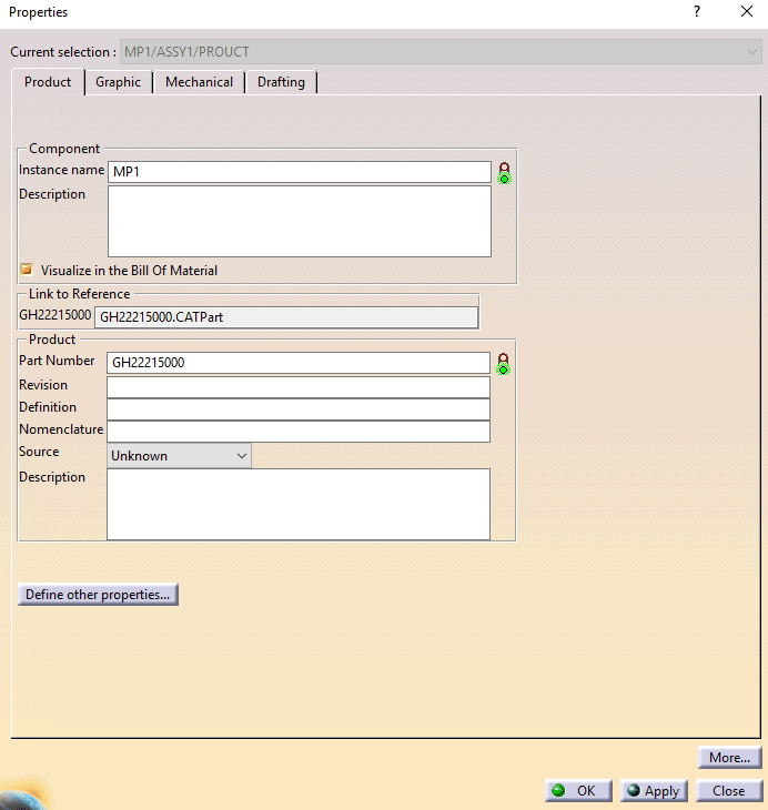

Hello everyone!
Is there any way to see "Instance Name" in exported BoM? I can not see it in available list. Mayby someone has macro which allows to select also "Instance Name"?

you can define your format whilst creating the BoM Analysis. Righ-klick on your part, look into the properties---what do you see there?
At least here I am able to find a couple more parameters which I can incorporate into my BoM

Yes, but unfortunately there (in BoM Analysis) is no "Instance name" to select. I am wondering how to export BoM with "Instance Name"
but what properties DO you have? (right klick on the part, properties)

Please try to create structure like that and export BoM in which you will se "Instance name".
I made SS.
in the Analyze - Bill of Material you have the listing report tab, see that you add "Name" parameter as a Displayed property
