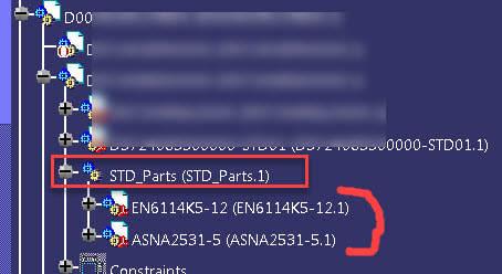

Dear All,
I want insert an STD part inside a product using vba please help me for it.
---First need to create a new product using insert new product name should be (STD_parts)
---After this need call STD parts from the local folder and positioned in a product.
Parts should be place using excel co ordinates like below.
PartNumber Fasteners Diameter Type Xe Ye Ze Xdir Ydir Zdir
D5724085500000 Fasteners Diameter_0.313_(5/16")_|_7.9mm en6114K5-12.263 4821.16mm 3237.365mm 194.177mm -0.033227856 0.058947539 -0.997707922
D5724085500000 Fasteners Diameter_0.313_(5/16")_|_7.9mm en6114K5-12.264 4858.672mm 3251.013mm 193.735mm -0.033599881 0.05992018 -0.997637519
i have recorded below macro but unable to edit that.

Hi ferdo,
Yes i am able to insert a STD parts from CADLIB, but i am facing issue as its not placing properly with HnF reference. below is my result.
Could you please help me to place properly.
Below is the code to place the STD parts
