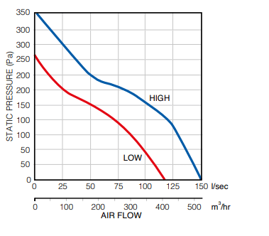

Fan curve is here. It is a two speed fan, so the two lines are for the high speed and low speed.
From here.

This fan is approx. 0.8" water guage (200Pa)...
To be honest I have difficulty understanding the meaning of the fan curve test.
Based on the curve, with airflow being the independent variable on the graph, I assume they control the airflow and that affects the pressure created at some opening? So this airflow variable represents varying system resistance, which affects the pressure the fan can generate?
(edit apologies for sounding like a student but I am a materials scientist and I have forgotten large aspects of my fluids course, graduation was 23 years ago...)
The fan curve is the power side of the equation.
Your system ( the duct) will create differing levels of friction / resistance to flow which varies as a curve with flow. Each system (length, diameter, other losses such as filters or louvres) will be different.
Where the two curves intersect will be your flow.
If you want a certain minimum or maximum flow then you need to design your ducting accordingly to get the two parts to match.
or similar - search "axial flow fan curve"
Most axial fans like to operate in the right hand 50% of the curve. So your linked fans quote a range of 400 - 520 m3/hr for the high speed case
