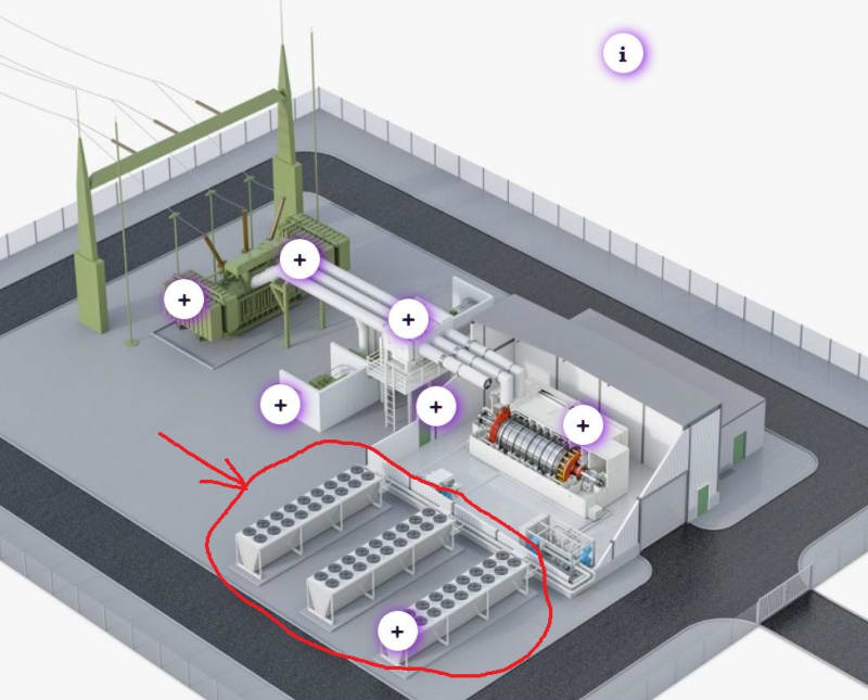

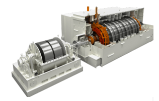

Siemens is now offering large Synchronous Condenser with flywheels, optimized to add inertia. This is one of the suggested solutions in the paper cited by Palletjack

The utility of the flywheel approach depends on the relative values of inertia, and power factor correction.

I'm not understanding why these idling synchronous motors (condensers) need a 1/3 of the infrastructure to be cooling.
Keith Cress
kcress -
In the diagram there seems to be 3 times as many fans on the motor as the transformer. Perhaps that could correlate to a transformer efficiency of 99% and a motor efficiency of 97%?
For one particular generator I am familiar with, the losses in sync condenser mode are about 3% of the generator nameplate. This is significantly more than the losses in corresponding GSU. I would expect a dedicated sync condenser running in partial vacuum to be more efficient than this particular generator.
I assume Siemens in not yet using superconducting materials.
Probably running in hydrogen rather than a vacuum. Hard to extract heat in a vacuum.
The little blue units in the bottom right corner of the plant look like hydrogen compressors.
Good points all. Their ad blather stated "for energy saving the rotor runs in a partial vacuum", so maybe not H2. Perhaps the blue things are some form of plumbed-in water cooling, possibly the stator or even insane rotor plumbing?
Still seems like a lot of cooling to me.

I think that the flywheel will run in a vacuum, but not the motor. At high ratings (100 MVA +) this could be hydrogen cooled.
Quite a few of the gas turbine driven generators I used to work on had clutches between the generator and turbine, (google ‘SSS Clutch’) so that when the turbine stopped the generator could run on, providing inertia and VAr control etc.
Siemens have taken this a stage further and added further Inertia by way of a flywheel.
As regards cooling of the motor, then remember that friction and windage can be estimated at 1% of the motor rating. If the motor is rated at 100 MVA, then even that is 1 MW!

Enter the synchronous condenser - a synchronous machine operating with relatively light "active" power and huge "reactive" power loading. This is not new technology by any means - it's been around since at least the early 1900s. Utilities have been quietly employing it (instead of building new power plants) since the 1950s, at least. For these types of "utility size" units, the ratings are so high that even a small inefficiency adds up to megawatts. Couple that with the fact that a significant portion of the energy is consumed in the rotor (compared to the stator in more traditional units) and it becomes much harder to effectively cool the unit. Hence the need for large-scale external cooling facilities like the artist's conception shown in the manufacturers' brochure.
And yes - the flywheel can operate in a vacuum (sometimes it does, sometimes not, depending on who designed the drive train). The generator itself will likely have H2 or - worst case - He as the gaseous medium to transfer heat from the internal components to where the external system can do something with it.

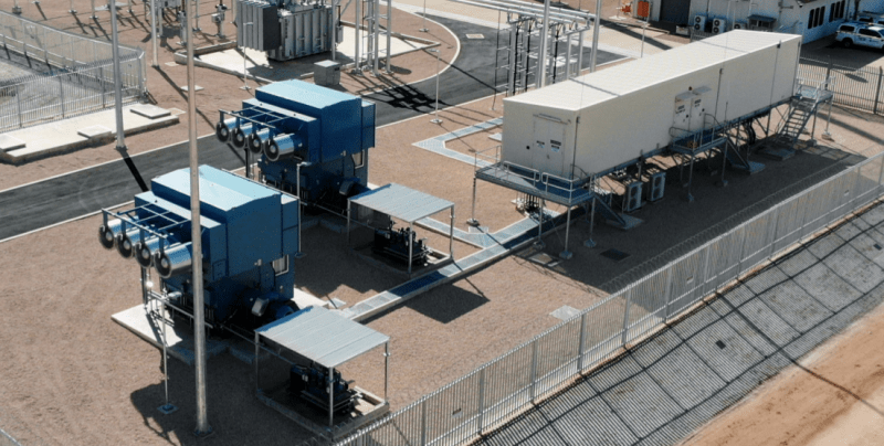

ABB seems to take a different approach with synchronous condensers, with the units being individually smaller, but using several. Many use an air to water to air indirect cooling approach, or an air to air approach. External flywheels are an option.
See the attachment. Lots of tradeoffs here to chose from.

https://www.siemens-energy.com/global/en/offerings/power-transmission/portfolio/flexible-ac-transmission-systems/synchronous-condenser.html[/URL]]To provide maximum inertia, Siemens Energy has extended the established synchronous condensers solution with additional rotating mass from a flywheel... Siemens Energy’s flywheels are operated in partial vacuum to minimize air friction losses and reduce the cooling efforts to maintain required temperature level in all operational and emergency modes.
Would it be easier to enclose the entire spinning portion in a partial vacuum rather than having rotating seals?
No, because you still need to extract rotor heat across the air gap. Can’t do that well in a partial vacuum.
I suspect all the extra cooling is to greatly exceed the temporary normal limitations that can be seen on the generator curves. It might have been much cheaper to chill the generator rather than build a huge unit. If a neighboring unit trips, this unit will immediately start dumping large amounts of MW and VAR into the system until other units ramp up.
