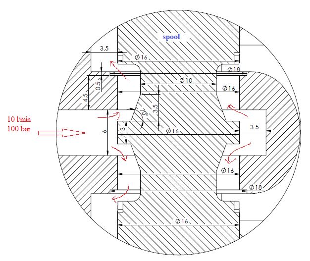

Hii,
Attached picture is a spool in valve assembly.
How can we calculate the pressure and flow differences occurring due to the construction of spool.
Is this meant to be a precision flow or pressure control valve? If so, you need to pay attention to machined edges of the orifices. A slight change in the break of an edge and the flow/pressure characteristics will change quite a bit.
