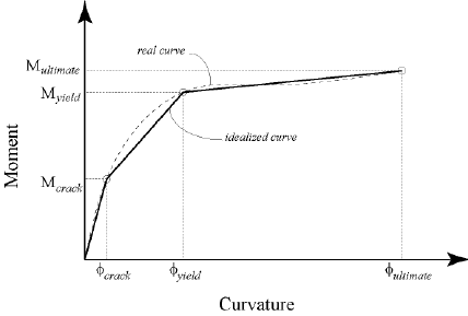

If the beam is RC (and it's probably similar if it's steel) you can find a curvature at failure, curvature at yield and curvature at cracking moment. Those 3 points determine a moment-curvature diagram. Behaviour is practically linear in between those points.
This can easily be done with excel, matlab... and then for any moment you can determine a curvature. You can do this for a number of points along the beam. From the curvature distribution you could get rotations with numerical integration (also in excel, also an easy task) and then integrating again, you can get deflection.

One simplified approach is to take the kinetic energy of the impacting body, and set it equal to the strain energy absorbed by the post. You can back-calculate the deflection of the post from the equations of beam strain energy under bending load. The equations would be piece-wise and vary according to the softening stiffness of the post as it yields. In other words, the total strain energy absorbed is the area under the force-displacement curve (if you used the tri-linear model that hardbutmild suggested, the strain energy absorbed by the post would "fill" the area under that tr-linear curve until the kinetic energy "ran out").
