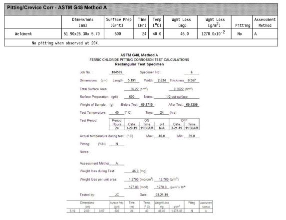

I have just tried to qualify a Super Duplex test using 3/4" Sch 160 pipe and it is failing on the corrosion test!
The test was welded in the 2G position with the following parameters:
Wire ESAB ER2594
Root 75A, 11V, 1.8 in.min TS ((27,500 J.in)
2nd Pass 95A, 11.6V, 2.9 in/min (22,541 J/in)
Fill & Cap 95A, 11.8V, 3.4 in/min (20,018 J/in
Shielding Gas 100% Ar
Backing Gas Ar + 2.5% N2 (Maintained at < 50ppm O2)
Testing carried out was as follow:
Tensile Test 122,000 psi & 127,000 psi
Bends Acceptable
Micro Exam - No continuous precipitates in the grain boundries.
Ferrite Count - Weld Cap 39.9%, Weld Root 32.7%
The microstructure was examined for intermetallic phases, nitrides and carbides. None were observed.
The microstructure was observed for sigma phase. No evidence of sigma phase observed.
Corrosion Test G48 (40°C for 24hrs) - No Pitting
Weight Loss 12.7g/m2
As you can see the test for pitting was good but the weight loss was over the required 4g/m2
I'm really not sure where to go from here!
Any advice on changes that I could make to improve the weight loss would be greatly appreciated.

We are doing a G48 Method A test per the customers specification. It is also pickled per the customer requirements. The customer also stated that impacts were not required on this material thickness.

As far as Heat Input is concerned, I maintained a Max Interpass temp of 160F and I used forced cooling between passes so it was not at high temps for very long.
The details of the test are below:
So if this is a pitting test the only surfaces that should be preped are the cut faces, and 600 isn't fine enough.
The sample should be full thickness with OD and ID intact.
If you section out a piece for testing you are exposing a lot of internal material, and you have a lot of metal being tested that won't be exposed in service.

I may be missing something but why are all surfaces exposed to the acid when it is only the pipe ID that will see any exposure to the service fluid?

I don’t think it’s a dumb question. I did not test the pipe alone but did ensure that the pipe was tested at the mill and the results were shown on the MTR. I don’t have it in front of me but I think the weight loss was 0.006g/m2 (50C for 24hrs)
We always re-test the base materials because it lets us see testing differences.
The G48 tests are not very precise at all.
We don't use pract A, we use C or E.
We like the acidified solution because it is more stable and repeatable from batch to batch.
Of course it is more aggressive so the temps need to be a little lower.
And I am a bit surprised that with a superduplex you aren't using the 72hr test.

One thing that I would do is run the G48 at 35C and see if you have zero wt loss.
I suspect that it a minor issue that is giving you problems.
