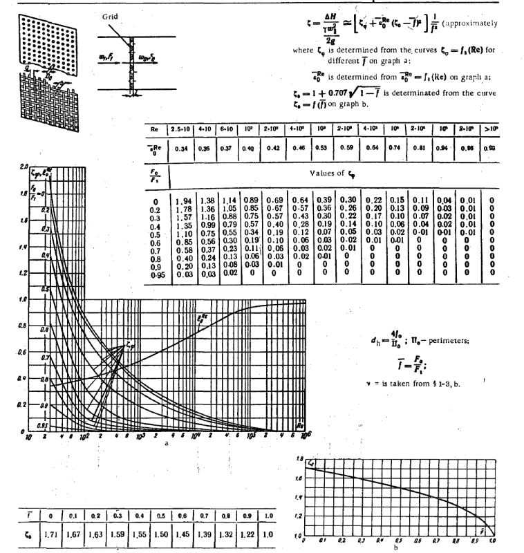

For Zeta Phi in Idelchik 3rd Edition diagram 8-5, do not use the equation from the book
I'm still looking for an equation that has output that matches the data in the table.

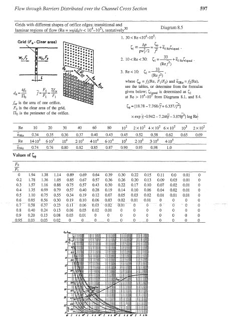

Isn't the referenced equation only valid for R.e <10, while the table is mostly for R.e values > 10? Idelchik shows two other equations that apply to the rest of the table, one for 10<R.e<30, and one for 30<R.e<10^4-10^5 That's from the 4th edition

Thank you for taking a look IRstuff, but Zeta Phi is only required for the resistance coefficient equation for the 30<Re<10^4-10^5 range, and of course most of my flows occur in that range. For Re<10 and 10<Re<30, Zeta Phi is not required. The paragraph that begins with "where Zeta Phi = f1(Re,F1/F0)...." applies to all three resistance coefficient equations, but Zeta Phi is only in the resistance coefficient equation (1.) for the 30<Re<10^4-10^5 range.

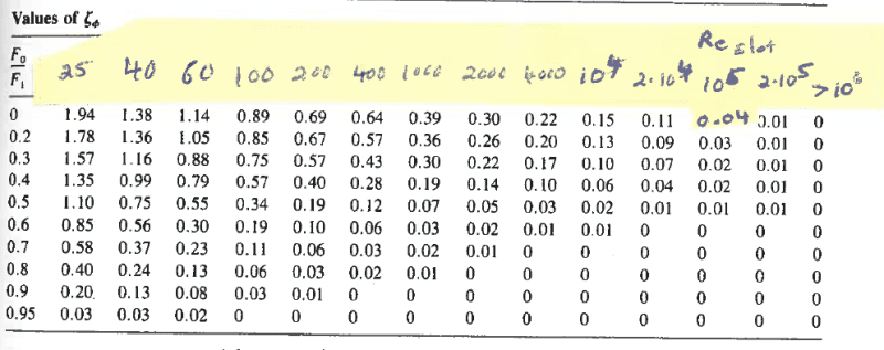

That reminds me, the 4th edition is missing the Re values. I found these column headers in the original edition.
For now I use the table from the original edition, but it would be nice if there was an equation for it. It is pretty difficult to make one equation for this table. Is anyone up for the challenge? It is beyond my mathematical abilities.

This is what I see in the text I have access to. The headings you ascribe don't match the headings in this text, although the typo in the table matches. do match the table in the English translation of the Russian version

Thank you pierreick. I'll have to do some research on this. It is difficult because the graphs of the curves look like graph in the book. I can't make a curve-fit equation that would combine the data for each fbar row.

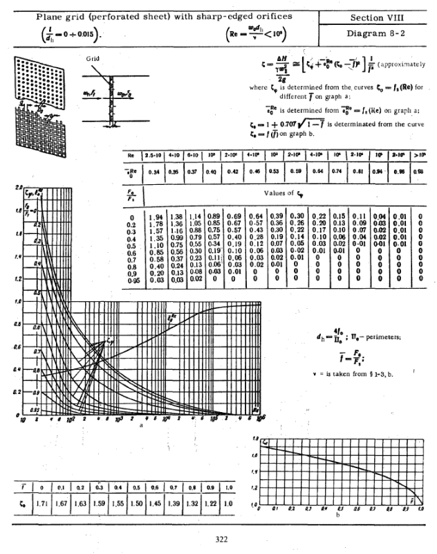

Thanks for responding IRstuff. Yes, that's part of the problem. The 4th edition doesn't have headings for that table. Notice how there are two EpsilonBar0Re rows in the table just above the Zeta Phi table in the 4th edition. Here is the page from the original edition.
IR, the third row is labeled Re too, so what up with that? 22 values/columns of Re in the top 4 rows, but the table is only 12 columns. Idk, but somethings wrong somewhere.

Yes, I see that now; sorry for the confusion; I've edited my posts above. The English translation of the Russian text shows the same Diagram 8.2
link to PDF, but the quality is pretty poor. I would definitely go with importing the data into Excel and try a data fit, although you could possibly digitize the graph a from the text
