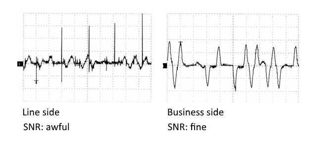

Yes, I know them well. Done them soo many times from inductosyns to 400 Hz in planes and Fanuc/Siemens CNC:s in-between. And I have had a THS 720, too. Loved it.
I used "ground" for the reference potential when measuring that resolver output. If the reference is connected anywhere else than to the resolver winding S* then you get the signal, carrier plus modulation PLUS interference. That is why I asked. But if the measurements were taken between S1/S2 or S3/S4, then there shouldn't be much interference at all.
Pic shows a similar situation (no resolver, this was communication in subway but the principle still holds. If interference can be seen on business side, it is mostly due to either dubious bonding or measurements taken with wrong reference. I still think that you have a problem with corroded ground path. As I said in my first post. The fact that it occurred after weeks of inactivity (things keep in shape when you move/vibrate them and also if some heat is allowed to keep moist away). Just sitting there for weeks (in salty mists from the Pacific) often leads to exactly the problem you describe. The field support at Mori Seiki or Yaskawa should know about that.
Gunnar Englund
