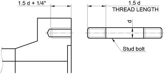

I would like to design Studding flanges for high pressure exchanger.

Be careful, this design is to hold the stud in position during disassembly. The stud must not rotate, the flange threads may be damaged. Once installed, avoid removing the bolts.

How can I fix stud bolts to Flange?
Can I do tack weld between stud bolts and flange?
The other side of stud bolts will be assembled with heavy nuts.
I think my idea is slightly ridiculous.
But, Tack welding may be broken easily due to bolting load!
Is there any good idea to fix stud bolts to flange?

1) Never do any welding on the bolt.
2) See more reading in ASME PCC-2 Article 303

In Pressure vessel design manual 4th ed. by Moss,
A length of Tapped holes on flange is specified as( 1.5 x Dia. of stud + 1/4" ).
the above length seems too long!
When assembling Stud bolts to flange's tapped holes, Stud bolts are always tightened seriously??
I think Stud bolts insert into tapped holes by 1.5 dia. of studs and the other depth, 1/4" is considered as margin!
gotothesky, UG-43(g) gives rules for depth of tapped holes. You can likely go less than 1.5*d.
Studs are sometimes made with extra length (say 1*d) and wrench flats formed on the extra length. This provides a means for removing the studs without double-nutting or using special tools. The studs also may be held when breaking the nuts.

This design requires a experienced fabricator, careful machining, extra clean of tapped hole, etc.
Why did you choose that design for a heat exchanger?, What is the design pressure?

Exchanger's design pressure is so high(about 150 barg)!
We can reduce B.C.D(Bolt Circle Diameter) with Studding flange.
It means we can reduce flange moment, and reduce size of flange!
I plan to studding flange as above!
