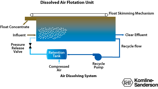

Thank you BIMR, I checked the full text paper on the DAF System: my understanding is they use a mixer, they pressurize, and use the DAF SYstem for air flottation: my concern is it is scaled for large water treatment plants: who could reduce this system to my needs ? the idea is excellent, but practically, I dont see how to move on: I doubt Veolia, Suez or Degrement will even respond to my mails.
DO you know if from this technology they have developped smaller applications ? In their study, they made a pilot of 21 liters, but it is a pilot.. they will not sell or manufacture for me such pilot.
Do you have an idea on how to proceed ? Also, to feed it with pure hydrogen would be totally experimental: I am wandering if it would give similar results as sonification, cavitation, ceramics etc..
EdStainless, I heard the limit is about 4%, this is why most hydrogen gas inhaling machines run from 2% to 2.5 %, not more. BUt in my case, I am in instant injecting of the gas in a running water, not in stored container: the water runs directly to the dip irrigation systems (roots).
In application of the DAF unit, bench top scale units are used to demonstrate the DAF process. There are plenty of smaller copycat firms that make DAF units. Enquire where you can purchase a bench top apparatus. Cole Farmer makes one.
The key is the capacity of the saturation pressure vessel. The saturation vessel is typically 3 to 7 atmospheres.
The key aspect of getting the correct bubble size is the valve characteristics.
