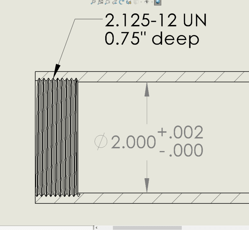

I am designing a Hydraulic Cylinder with a threaded gland. I have experience designing hydraulic cylinders but never a threaded end. I am looking over my ASME VIII Division 1 codes to try to determine the thread engagement needed but the only thing I have found is section UG-43. Table UG-43 has a chart telling me thread engagement for NPT threads for a pipe into a plate. The issue is I am threading a cylinder into another cylinder and I am not using NPT threads.
I am assuming that threading into a cylinder is not an issue but I was curious if using different threads would allow me to use fewer threads. We will be mass producing these and the fewer turns our production needs to make the more time we save. Does anyone know a way to calculate minimum # of threads needed? my knowns are:
Cylinder max Pressure = 3000psi
Cylinder I.D. = 2in
Cylinder O.D. = 2.375in
Threads (Custom machined): Major Diameter = 2.125, tpi = 12 threads
I currently have 8 threads engaged as per Table UG-43 but does anyone know if I can reduce this? If so, How do I determine how few threads I can use?
Attached is a photo of the current design.

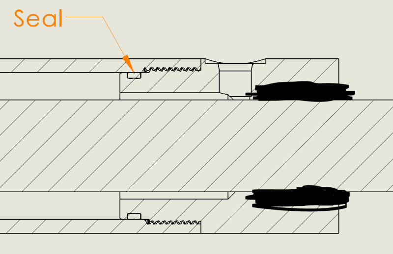

This should give you all information involved with how these attach. I didn't want to show all dimensions on these parts because they are parts that we are designing to build in house and sell. I think App 2 and App Y do not apply because they are about the force the bolts need apply to seal properly (if I am reading them correctly). As you can see on these images, the seal is accomplished by the tolerance fit between the two parts. The only factor I need to consider is that my threads will hold up when the cylinder is fully pressurized. The force at full pressure will be 3000psi * [pi*1^2]in^2 = 9425lbf.
That looks a lot like what we were doing.
Into a honed bore you don't need a special land for the o-ring.
But the transition from the ID to the first thread is super critical so that it is smooth.
Adn being able to install these without the lead lip of the head damaging the ID surface where your o-ring will seal is a balancing act.

To help damage to the ID sealing surface, would changing the chamfer to a large radius help prevent any scratches?
Also when the threads start, the end of the lead lip will still be over the threads, and by the time it reaches the sealing surface of the ID the threads along with the seal should be aligning the part to not scratch the tube wall. However, my big concern with this is spinning that seal over the threads and it cutting into the seal. Did you ever run into that issue?

We had the tolerances on the o-ring, the groove, the threads and such all skewed slightly so that regardless of how they stacked up we had enough clearance.
We rarely nicked an o-ring.
We did very slightly take the points off of the thread profile.
