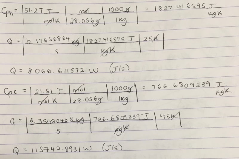

Thanks for your replies. My Q values are very far off, this is what's causing me the trouble. I have been determining cp values from the ideal gas heat capacity equation found in Chem Eng Design by Sinnot and Towler.

So this is what I get using inlet T of 25, 110 an outlet T of 70 and 85. I believed that the outlet T could be calculated by equating the q values but that gives me a negative value of T so I used 85 as a trial. The values are very different. I honestly thought this would be the easiest step of all but it seems I have no knowledge when it comes to heat transfer!
Thanks again for all your help!
You appear to be randomly plugging and chugging with no understanding of the basics of a heat exchanger. Where is the heat exchanger in all of your calculations? Why are you ignoring conservation of energy?
Did you take thermodynamics?
TTFN (ta ta for now)

SHD,
You calculated the heat gained/lost by each individual stream (Q = mdot * Cp * dT), and found they are significantly different than each other. This tells you that the value you randomly chose is not the correct one. It also tells you that the approach you used is wrong, as is your understanding of the thermodynamics at work. That makes me a bit concerned.
Heat gained by the cold stream is equal to the heat lost by the hot stream (minus loss to atmosphere). So if the 110 C stream is taken to 70C, the other stream would be:
635 * Cphot * (110-70) = 12,077 * Cpcold * (Tf-25). Solve for Tf.
The hot stream doesn't have enough enthalpy to heat the cold stream up to 70 C due to the low mass flow rate, so the above approach is the only one that makes sense.
That's only the first step on Hx design. You have a Q, but now need to determine the other heat exchanger parameters. Q = U*A*dTlm is the governing equation for a heat exchanger. I do not know how in-depth you are expected to go on heat exchanger design. I doubt they need baffle spacing, TEMA type, etc. Finding a organic gas to organic gas U is probably good enough for the design. Rigorous design would take into account pressure and temperature effects on viscosity, which effect the local Nusselt/Prandtl number. That's something for a computer to solve, not a college senior.
Edit: Equation edited for clarity.
