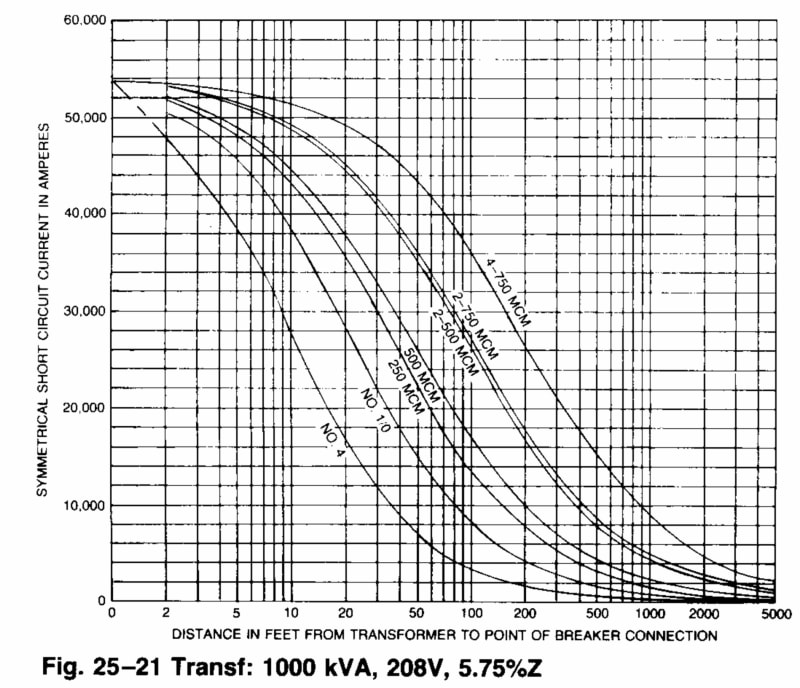

Here are a few observations to consider.
1) Appears that 2,385A was forced to be approx. 80% of the SWGR breker rating.
2) The utility SC has a small impact on the load side since the transformer and feeder impedance are the dominant factors.
3) For 208V, motor contriution usually is accepted < 50% total installed load.
4) Voltage drop at 208V need to be considered that force to overside the feeders.
5) The prospective SC at the feeder end is estimated in the graph below
6) There is an estimated connected load and the larger feeder length?
Depending on branch length, voltage drop may control the sizing of many of your branches. In the extreme case undersized branches may delay protection tripping, and increase arc flash energy.
