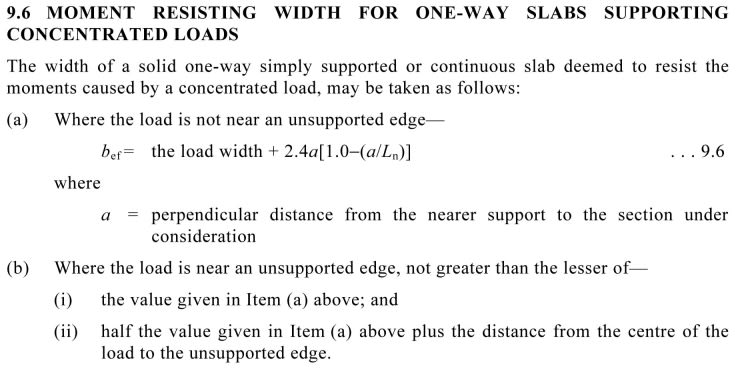

Hi All,
I'm being asked to design the post installed anchorage connections for a patient lifting system at an assisted living building. The lift system has a main rail that is anchored to the bottom of the concrete slab above (9" thick), at 4ft on center. The loads on these anchors are small (300 lbs), but I'm being asked to confirm the concentrated load from the anchorage will not exceed the floor live load of the slab above (40psf). Is there any generic rule of thumb that can be used to distribute a point load over a certain area of the slab to prove this load will not overstress the slab above?
Not that I'm aware of.
Just have to use engineering judgement based on the type of slab (one-way, two-way, short or long span) and decide.
For a one-way slab I usually like to spread it out over about 2-3 feet of width of a slab strip and then see where I'm at.
Outside ACI 318, other concrete codes have a methodolgy to determine the width of one-way slabs which support concentrated loads.

The floor live load isn't a distributed load, either. It's modeled that way for convenience. That slab and slabs much thinner than 9" support 300 lb point loads (footfalls of 300 lb people) day in and day out.

its 300 lbs every 4ft, and i doubt the load is always that high. That is 75 plf along the run of supports and if you assume 3-4x slab thickness as effective width you are down to 20-25 psf effective which i think is quite conservative. I wouldn't really be too concerned.
