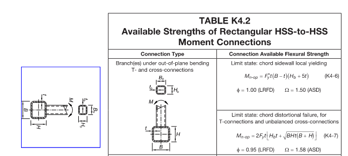

JT-1995 said:
https://www.eng-tips.com/viewthread.cfm?qid=506350[/URL]]In regard to the tables in Section K of AISC360 (specifically K3.2 in 360-10 or K4.2 in 360-22) the formulas seem to be derived for a vertically oriented branch. Examining that closer, it appears the branch is connected to the width (B) of the chord and the moment load is oriented bending in what we may call the "weak" direction. I believe this is all because these codes started development because of HSS TRUSS designs not horizontal beam designs...maybe.
So if you agree with any of the above, if I am designing a T connection of a horizontal HSSS12x8x3/8 branch beam Teeing into the 12" face of a horizontal HSS12x8x3/8 chord beam. So to determine the flexural strength I need to flip flop all of the H and B variables. Does that seem right?
The tables don't care so much the actual orientation of each member (vertical or horizontal), what is important is the relationship of the two members to each other and the direction of the loads/moments (in-plane, out-of-plane, etc). The variables (B, H, etc) should always match the actual geometry. That is, "H" doesn't care if it is the 12" side or 4" side of your beam, "H" is going to be whatever side of the beam matches the picture. It sounds like you are describing what I have shown below, with image rotated 90° on the left. If your girder is oriented in the "strong" direction such that it is 12" tall and 8" wide, "B" is 12" and "H" is 8". If it is oriented in the "weak" direction such that it is 8" tall and 12" wide, "B" is 8" and "H" is 12"
Per your questions in the above post, up through AISC 360-10, HSS connections were exclusively covered in chapter K. In AISC 360-16 chapter K was completely reorganized and chopped down because many of the required checks were required in chapter J, and the committee did not want to have multiple locations with the same information. So yes, J is definitely applicable to HSS and yes, K provides addition requirements/information specific to HSS.

Thank you again dauwerda. Yes your rotated image is what I am designing. I think we land at the same place, I appreciate you taking your time to describe the orientation.
Also, thanks for connecting the two posts. I had the STI limit state tables but had not found them helpful. This morning I looked at them with fresh eyes and I see their value now for my design in the last table.
Cheers.
Just a caution, some of the tables have a 'range of applicability for the HSS properties.
