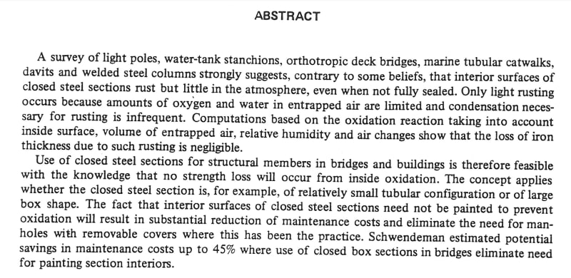

What is typically done to prevent corrosion on the inside of HSS columns? Structure is not exposed to elements, and top ends are uncapped. Client is concerned they will rust from inside out.

This is an old document but matches my own experience. Sealing prevents corrosion. Galvanising is fine in the right environments. Inspectability of open sections is a virtue only if maintenance is actually done, otherwise you're just watching two surfaces corrode instead of one. I see the situation as analogous to reinforced concrete.
yes, its pretty benign environment, inside of an air conditioned plant. The owner is just being really picky and comes up with all sort of weird requests and complaints. Not really feasible/cost effective to HDG those at this point (they are already primed and erected), so I am thinking of suggesting concrete/grout fill. Columns are 8x8x3/8. It will probably take over a century for those to rust through even outdoors.

"......its pretty benign environment, inside of an air conditioned plant...."
In that case the corrosion risk is negligible because the likely time of wetness of the surface will be zero or very close to it. No need to do anything.
