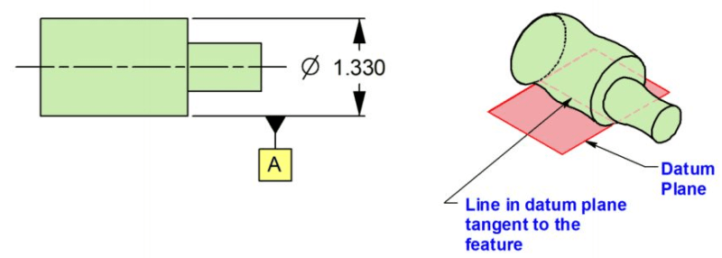

How you read this drawing?

I've always been under the impression that if the drawing creator missplaced the datum feature symbol for a cylindrical surface, the datum is still the axis (yes, even the datum feature symbol is not aligned with the size dimensions, AGAIN, on a cylindrical feature and not on a width/ tab).
Anyone else seeing this otherwise?
I will learn from anyone.
Again, as I stated before, for me if someone misplaced the datum FEATURE SYMBOL on a cylindrical surface (not on a width or tab) I will interpret it just as I stated, A MISSPLACEMENT and NOT that the datum is now a plane (or a line) instead of the axis.
opposite opinions are welcomed and encouraged.
Sure, why not. I agree to make you happy. I'd personally demand the drawing be fixed or just ignore the drawing because the rest of it is likely also just "misplaced."
Maybe I haven't wasted enough of my life playing junior GDT prosecutor. The intent is clear. I'd skip right past this without a hangup. The datum is the feature, not the dimension.
That said, what am I missing? What is the requirement?
The question is a quite simple:
Could shown callout be interpreted as datum target line or plane?
Or otherwise stated, would you read the print this way, as datum target line or plane and not datum axis?
Still think the answers of my above questions are: NO
I agree with not worrying about it. The chance of misinterpretation is very small; "the datum of a cylindrical datum feature is the axis of the datum feature simulator."
edit: If the diameter symbol were missing from the related dimension, there could be problems.

In the drawing posted by OP (which is a new tip from Tec-Ease), the datum is apparently the tangent plane (based on ASME Y14.5M-1994, Y14.5-2009, and Y14.5-2018). I do not understand why the datum is not the axis of the cylinder, which is the datum feature. Can someone please explain? Thank you.
Tec-Ease answered and admitted that their choice of using cylindrical feature (to get the point they were after) was not the best.
They should have been using a width or tab to make it clear and less ambiguous.

From the tec-ease tip pertaining to the above feature "In the view below, because the datum target feature is offset from the size dimension line, the datum may be interpreted as a line lying in a plane tangent to the feature indicated."
It doesn't say that is the correct interpretation, rather that it is a possible interpretation. I think 99% of the time one can assume the intent is to designate the entire diameter/axis NOT the tangent plane/derived line contact, however why leave the room for interpretation? The standard lays out and depicts several methods for acceptable datum feature symbol application to a cylindrical FOS, this is not one of them (though a somewhat generous reading of the text could possibly be interpreted to allow it).

It is hard to disagree with such authority, but IMHO I think they are just plain out wrong. There is no support from the standard for such explanation of datum plane and a line in the datum plane
Y14.5-2018 seems to directly support the idea that the OP's picture is a legal way of creating a datum axis. According to 6.3.2.1(a), the datum feature symbol may be "placed on the outline of a cylindrical feature surface or an extension line of the feature outline, separated from the size dimension, when the datum is an axis." (My emphasis.)
So it's not a misplacement. And there's no tangent plane idea here.
EDIT: I see a cylinder as having two outlines -- circular view and lengthwise view. So when they say "outline of a cylindrical feature surface," that seems to allow for the lengthwise view being tagged as a datum feature, even separated from the size dimension.

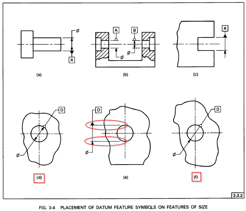

That description from Y14.5-2018, 6.3.2.1(e) has existed since 1994. See below from 1994, 3.3.2 (c) and Fig 3-4.
My interpretation of the "outline" would be the circular one as 3.3.2 (c) refers to Fig 3-4 (d) and (f). And the "extension line" of the feature outline would be something like the extension lines shown in Fig 3-4 (e). Though 3.3.2 (c) does not refer to it. 3.3.2 (d) calls out Fig 3-4 (e) but it seems mismatching.
