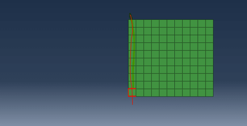

Dear all,
This is the file I created it for the error. "Infinite elements must share a complete face with one and only one other non-infinite element. The elements in element set ErrElemInfiniteAdjacency are not properly connected."
Can you help me know this error?
Many thank you.
 https://files.engineering.com/getfile.aspx?folder=d5a59e2d-5cb3-4817-a0fd-e909e85e05ca&file=SOLID-5.inp
I never had really good success when using infinite elements except of very simple cases. So good luck because they are tricky to use initially until one understands them.
The only thing I can suggest is to look on the help manual section 25.3.1 about infinite elements.
I think in your model you only need one layer of infinite elements not many. Thus use only one layer next to the C3D8R elements. So basically if you look in help infinite elements are not suppose to be connected to each other along the 'infinite' direction
See the attached which marks the infinite elements (just one slice), the rest has been deleted. Also look in the help to see how long to make the element along the 'infinite direction' - not sure if square is ideal.

Apart from the fact that you should use only one layer of infinite elements, you must also make sure that their node numbering is correct. It should be such that the first face of each of these elements is connected with finite elements. In your case the direction was opposite (infinite direction pointing towards finite elements instead of far field). To change this I:
- deleted all infinite elements apart from one layer (Edit Mesh —> Element —> Delete)
- created geometry from all elements’ faces (Geometry Edit —> Face —> From element faces)
- made a partition of unit thickness to assign these infinite elements’ layer again
- assigned two separate solid sections to these 2 cells
- meshed thick region with finite elements and thin one with acoustic elements (important: for this thin layer region I used sweep meshing in the direction opposite to thick cell to make sure the infinite elements will have proper direction)
- generated input file
- changed acoustic elements to infinite ones
The analysis runs now.

In the previous post I forgot to mention some important steps that I’ve taken to fix this issue. So after the first step you should change this one layer of infinite elements into finite elements (like C3D8) in the Mesh module (Assign Element Type). Also after you create geometry from elements’ faces don’t forget to delete underlying orphan mesh and use Shape —> Solid —> From Shell on all faces. Otherwise you would have to mesh shell geometry.
If you want I can attach .inp file with working analysis.
