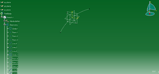

So there are two curves and after i exit from workbench, both curves were in same sketch. I just want to translate the bigger curve only in y direction but not smaller curve.Is there a way i can split those curve and separately translate curve independently?
You can also extract the curve from the sketch. Then move the extracted curve.
