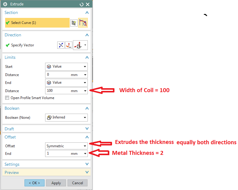

Apr 20, 2018 #1 bxbzq Mechanical Joined Dec 28, 2011 Messages 281 Location CN Hi there, I'm looking for a way to roll sheet metal as shown in attached picture. Thanks. https://files.engineering.com/getfile.aspx?folder=b20f4002-590f-434c-8337-466bde111ca2&file=Capture.PNG
Apr 20, 2018 #2 jerry1423 Mechanical Joined Aug 19, 2005 Messages 3,428 Location US It looks like this video may be able to help you with the curve, then use the curve to extrude the sheet metal with a specific thickness. https://www.youtube.com/watch?v=I995mTomo1g Jerry J. UGV5-NX11 Upvote 0 Downvote

Apr 21, 2018 Thread starter #3 bxbzq Mechanical Joined Dec 28, 2011 Messages 281 Location CN OK. I create one helix curve, offset it with sheet thickness, then connect the two curves. Now I can extrude from a close curve. Looks could do the job. Thanks. Upvote 0 Downvote

Apr 23, 2018 #4 jerry1423 Mechanical Joined Aug 19, 2005 Messages 3,428 Location US Select the curve and extrude in the direction of the width of the coil. Jerry J. UGV5-NX11 Upvote 0 Downvote

May 15, 2018 #6 deedub777 Mechanical Joined Feb 13, 2012 Messages 117 Location GB Now take this into NX Sheet Metal and run 'Convert to Sheet Metal'. You can then create the flat pattern. Upvote 0 Downvote
