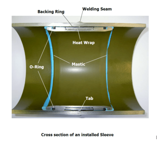

How to remove debris from internally coated pipeline with (TK 236) prior to commissioning (pigging or flushing)?
the pipes is 24in and the length is 55 KM.
the line pipe joints welded together using insert sleeve
Foam pigs.
Or soft cup pigs.
Or lots of water at 5 m/ sec...
is pipeline with internal INSERT SLEEVE piggable ?
You said internal coating TK 236.
What exactly is an insert sleeve?
Drawing, sketch or link would help clarify.
How much does it reduce the ID?
Did it have a sharp edge?
Why has it been used?
@LI - Google Thru Kote sleeve. It’s an internally coated sleeve with a heat resistant tape such that it can be welded on without coating damage giving a coated field joint. A foam pig should pass it.

Never seen these before, but seem a bit OTT to me. Any time I've looked at options to transport corrosive fluid, internal coating has been regarded as too high risk as application, inspection and potential for even a small piece to disbond or become damaged is seen as very difficult or likely to happen in the typical 25 Yr life of a pipeline.
I still can't find out how thick these are though and hence what reduction in I D is. Also are the end rounded?
Thinking a bit more, what sort and how much "debris" are we talking about? You might need a bypass pig to jet 10% of the flow through the pig. Or maybe a soft cup pig, either a single body moulded pig or perhaps a coated foam pig to last 50+ km.

I'm with LI on the "internal coating for corrosion control is a bad idea" front. I've been fighting it for 30 years. Given that the line is internally coated, how much 'debris' is actually expected? There's no rust or scale for starters, although there could be a lot of flaking coating[pipe]

Any idea of dimensions? I found a lot of nice pictures but no dimensions drawing or table.
So maybe 8mm?
That would be >95% ID.
But it's the constant clipping over 50+km I would be worried about. Pigs don't like that.
Did no one think of this before you built the pipeline??
The inside diameter of the pipeline is 584.2
The inside diameter of the insert sleeve is 556.2 (95.2% of the pipeline inside diameter)
Is the pipeline pigable?
You need to choose the right pig and let the supplier know these dimensions, but 95% is feasible.
Still a higher risk than a smooth ID so choose carefully.
