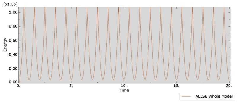

Hello,
How can obtain integral over the volume of the tensorial product of a stress field and a strain field in ABAQUS?
I would be so thankful for your help.
Elastic strain energy is available as ALLSE output variable.
Thanks, FEA way for your response I will try your suggestion.
Dear FEA way,
Exactly, I want the elastic strain energy I found the ALLSE (Recoverable strain energy) variable in history output in ABAQUS but the result depends on the time; normally its returns a scalar?
I would be so thankful if you can help.
You can view the attached image for details.
Thanks again.
What kind of analysis is that ? It’s normal that strain energy (ALLSE) varies with time.
The analysis is periodic, I think ALLSE is a scalar ?! that makes me confused
