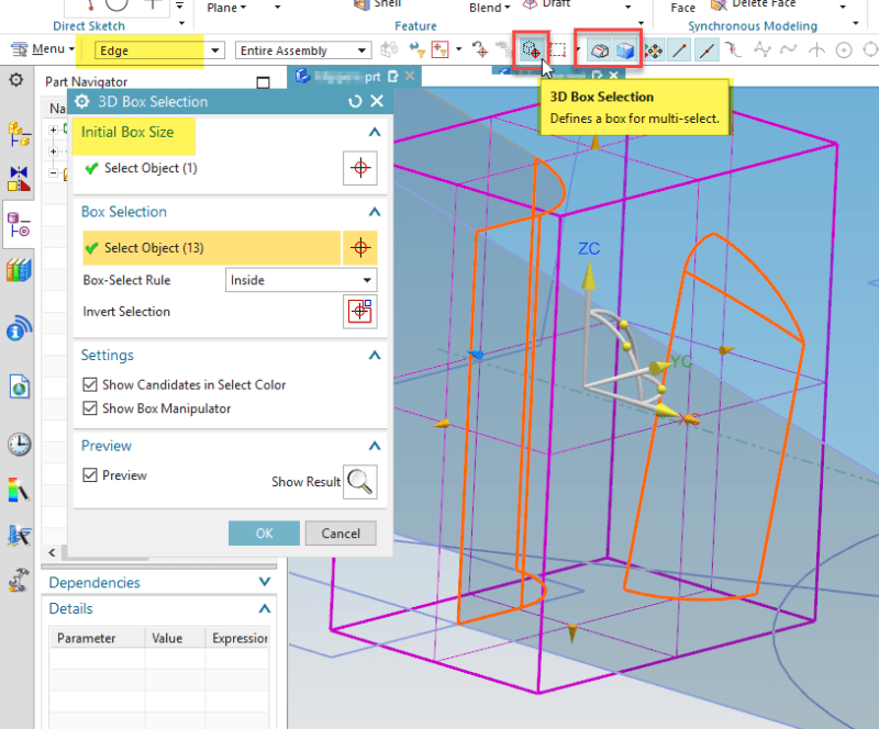

In NX12 * there is a selection method to select using a 3D box. ( Not cylinder, box only)
* always note the NX version.
You might need to enable that button to see it.
note that you probably need to toggle the Highlight hidden edges and Allow selection of hidden wireframe.
select button, select something not necessary to be selected for the initial box size, then drag /resize the selection box, and possibly set a selection filter to the type of object .
