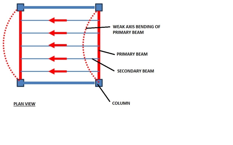

Do you guys have any idea on how to increase the minor axis bending capacity of a rolled-H section (no substitution by built-up section)?
Thank you very much guys.
Depends on how much... in an extreme, you can weld plates across the toes of the H section.
Thank you for your reply dik.
The illustration of plan view structure is shown below, it is an offshore structure. (I guess my weak axis bending concept is correct.)
Thank you very much.

However I would like to clarify on the diagram, sorry that I did not make it clear.
I would like to find ways to reinforce on the weak axis of the primary beam due to wave load.
What are those 'things' with the arrows on them and how are they attached? Joists? Can you add a plate toe to toe on one side of each beam? Can you do anything to provide diaphragm action for the overall floor plate and eliminate the bending in the beams? Can you use sheet metal strips, say 3" or 8" wide. diagonally from corner to corner attached to whatever flooring.

Are you stiffening an existing member, or scheming up details for a new design?
Plates/ flat bars welded between flanges or flat on flanges, truss-work across the square come to mind.
Investigate higher-grade steel members if available.
Switch to square tubing in lieu of wide-flange beams.
Fixed/moment connection at the corners.
Add some form of diaphragm? could be as basic as some diagonal braces or detailing any flooring over the beams appropriately to address the out of plane concern.
That seems to be the only way if strengthening the members isn't possible (which you're inferring?).
