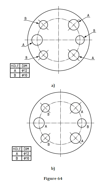

How to identify/demarcation 2 set of Multiple Identical Features
Bryan.mys
Aug 1, 2024
4
HK
I am working on a drawing with a bunch of holes. Those holes were scattered around the product with another set of similar looking holes. How should I indicate which hole belongs to which set? (apart from dimensioning them on different view)
I was wondering if it is ok to use annotations "a1,a2, a3, a4, "b1, b2" to demarcate each set and where they are, then place "a1~a4" under the 4X XX.XX.
 https://files.engineering.com/getfile.aspx?folder=646be36e-293d-416e-9cbb-c7045ce3b8ed&file=Screenshot_2024-08-01_193921.png
Hole tables are a common way to achieve this. Most CAD software should be able to do it automatically. ISO 129 provides the following example of "Tabulated repeated features":
