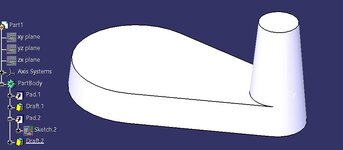

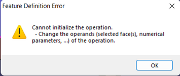

I want to give draft of two degrees to the following selected surfaces as one operation. But I am getting the following error. Please help.
thanks.
(I assume this is a CATIA question?)
I get a similar message when I try to draft the side faces. I guess it's because the cylinder is tangent to the base.
I could only do it with 2 draft features:
